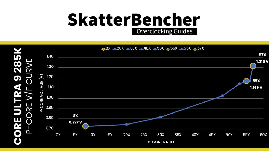

Apparently TSMC Process are not suitable for what Intel has their Process for High Clocks TSMC Process are good at low power but falls off at higher voltages way to quickly from the looks of it
Here is a reference of 285K with different clock multiplier fyi x =100 mhz and the multiplier is the internal CPU Multiplier it takes extra point 0.2V for extra 200Mhz

I hate to break it to you, but EVERY processes technology since the dawn of man has a V-f curve that falls off a cliff at high voltage. This isn't a TSMC exclusive phonemina look at any chip ever made. You will see the same thing. See the last page for why ARL actually has a lower Fmax.
Spoiler alert: Intel 7 is not higher performance than Intel 4 or N3...
