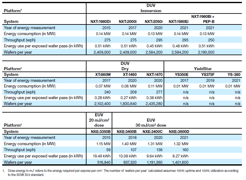

ASML's 2021 update of the litho energy consumption table, I'll also start separate thread:
p. 57
