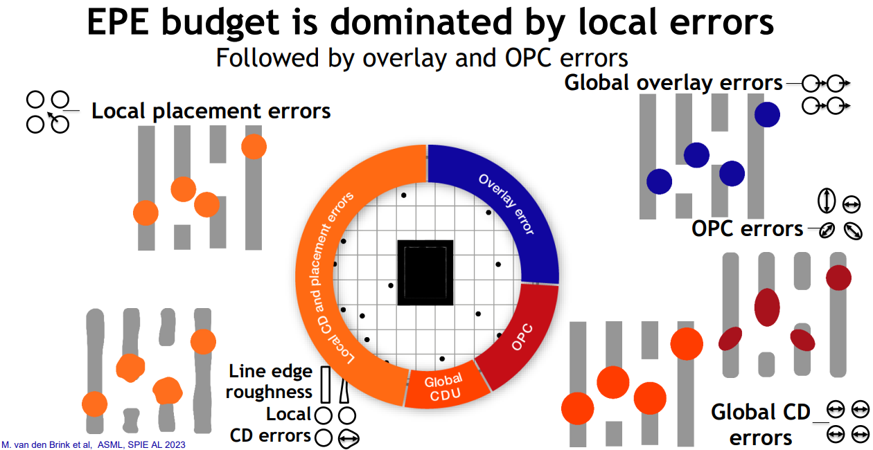

Guess you are not familiar with stochastic effects. Some explanation for the terms you used here. CD is low frequency/long range feature width average. Typically we measure CD and report CD, Local CDU and Global CDU. LER is the line edge position variation from ideal line edge. It is vulnerable to SEM noises and distortion. EPE would be a little bit complex. you can refer to the explanation from ASML in the following graph which combines factors in two layers.

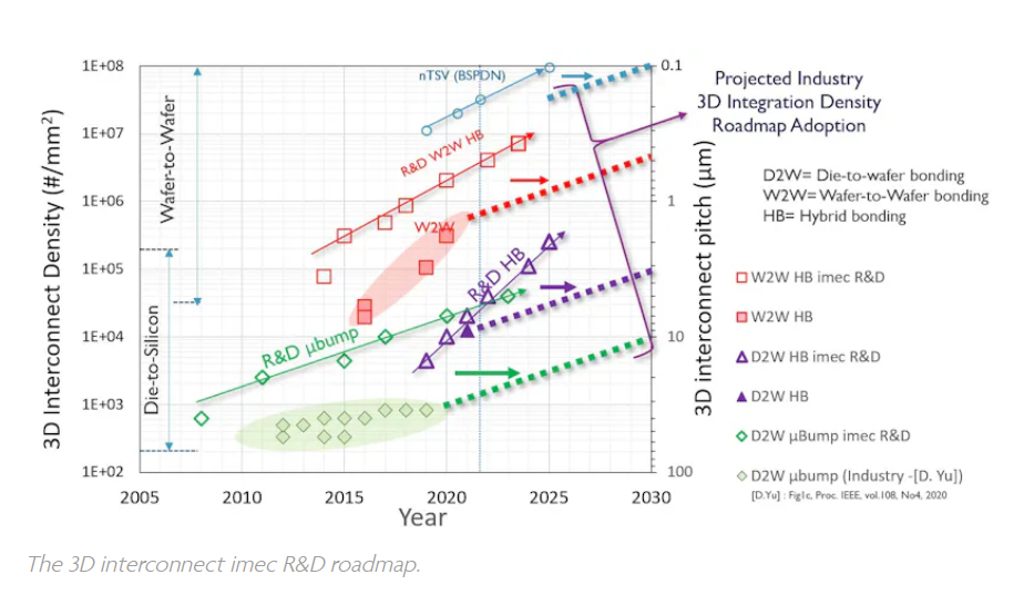

Imec doesn't expect any 3D stacking until like 2030-32. So while I think we will get to a NANDification of logic eventually. That doesn't sound to be happening until the mid 2030s at the earliest since TSMC has been pretty consistent that CFET then 2D then 1D for their 10+ year roadmap. As for high-NA I don't think it is about pushing to 8nm features (low-NA can't even do the 13nm). Fred, Tanj, and I were talking about this earlier. Since I don't want to put words in their mouths the TLDR of my thoughts was that the main application would be reducing multi patterning for middle layers rather than pushing min feature. For example doing something like N5's 30nm SALELE M0 with high-NA DP. If memory serves from a Nikon paper I read while ago they mentioned that DUV double patterning cost ranged from like 3-4x the cost of DP (depending on the scheme used) because you need at least 2x more litho, a bunch of extra non litho tools, and you drastically lower cycle time. Back to high-NA; if all you try to do is reduce the degree of multipatterning, now you only need the cost of a high-NA exposure to be to be like 2-3x the cost of low-NA exposure (adjusted the multiplier down because EUV is more expensive then DUV) for the fab to get a positive ROI.

Not sure what is your definition of 3D stacking from imec. If we consider W2W HB or D2W or tsmc CoWoS as 3D stacking, then it is ready now. FYI.
