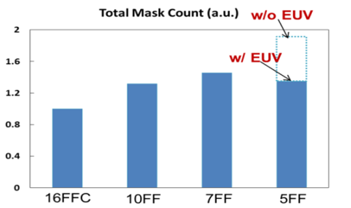

The mask count from 10nm to 5nm was comparable according to TSMC (at IEDM 2019). The main point they made was they had expected many more masks at 5nm without EUV.
That said, they do have special EUV mask handling in the fab (cleaning) due to lack of pellicles.
Thank you Fred. If not for EUV we would be using octuple patterning for 3nm?

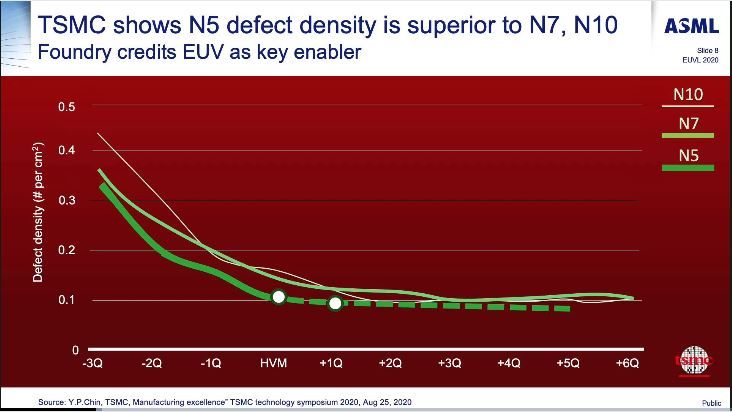

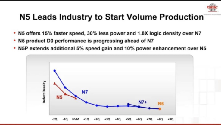

You also need to take a closer look at yield, TSMC is not like the others.
When Apple came to TSMC at 20nm TSMC started doing yearly process nodes (half steps) with a focus on yield learning. TSMC freezes a process in Q4 so Apple can have HVM for the iProducts the next Fall without fail. Remember, Apple designs a very big die every year so yield is paramount. Not just for price but also for capacity (good die).
This was a completely new methodology for the foundry business and it really has made TSMC unique. For example, TSMC introduced double patterning at 20nm then added FinFETs for 16nm in the same fab. TSMC did a similar thing with EUV. They started adding EUV layers to a node already in production (7nm) then increased EUV layers at 6nm (same fab) and 5nm which resulted in a lot of yield learning.
Intel, for example, is much more traditional. They went to double patterning and FinFETs at 14nm and will go from zero EUV at 10nm to full EUV at 7nm.
This Apple/TSMC low risk/high yield process approach breaks with the traditional semiconductor yield curves so you really have to take that into account when making chip price approximations.
Yield numbers, like wafer prices, are highly confidential but if you were to use 90% yield as an approximation for TSMC HVM I doubt anyone would argue against it.
