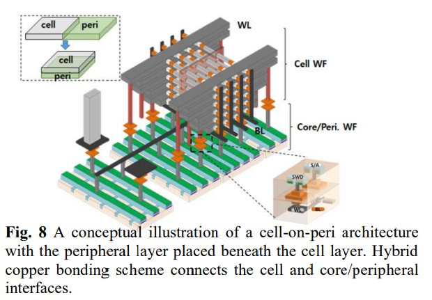

This is not a monolithic-3D DRAM, so the area rule economics will not change.
The real monolithic 3D DRAM promise dramatic per-cm² and per-bit cost reduction, this only allows to squeeze more DRAM dies into a single package.
It is monolithic. The only thing being bonded is the periphery logic which is already formed separately from the array (just on the same wafer). The application of hybrid bonding SK described is similar to YMTC's and Kioxia's most recent implementations of CMOS under array 3D-NAND.
Image credit from a similar Samsung paper:
