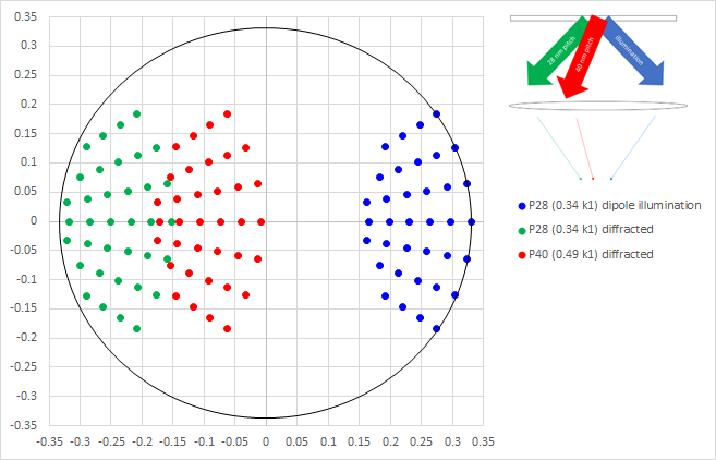

This is an interesting and useful followup to the UnitedLex teardown posted earlier: https://semiwiki.com/forum/index.ph...-bionic-soc-n5p-details-from-unitedlex.15273/
A minimum pitch (fin, M0) of 28 nm is confirmed in this teardown, though not in the previous one from UnitedLex (there it looked >~40 nm).
So it looks like a mix of 28-40 nm pitches is possible on a given layer (fin or M0).
However, illumination supporting 28 nm pitch is mostly detrimental to the focus window of 40 nm pitch. So it is an expected multipatterning application.

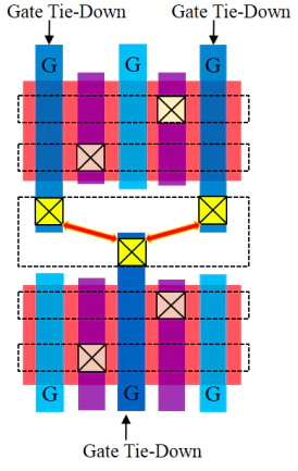

Fred terrific info and drawings.
Is the minimum area frequently derated/increased like this?
Asking more broadly, is it now conceivable that a N7 chip could pack more PPA than an N5 chip if it employed fewer or none of the area expansions you show above?

The article mentioned that single diffusion break (SDB) is becoming standard for other TSMC nodes (N6, N3), so would not have so much area given up as in the above case.

New isolations: STI --> DDB --> SDB (and CNOD variant)
CNOD involves a gate-tie-down (to the power rail) which robs a lot of area.
TSMC N5 uses CNOD (Skyjuice indirectly alleges)

New isolations: STI --> DDB --> SDB (and CSOD variant)
CSOD involves a gate-tie-down (to the power rail) which robs a lot of area.
TSMC N5 uses CSOD (Skyjuice indirectly alleges)

What is CSOD? Is this how they call a non-COAG gate construction now?

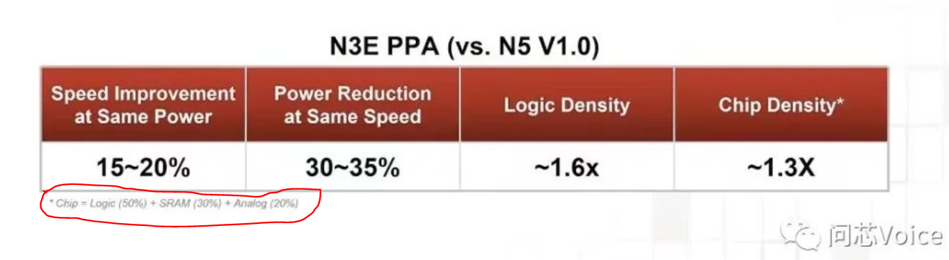

TSM counts chip density by 50%*(Logic)+30%*(SRAM)+20%(Analog). From TSMC Tech Symposium. FYI.
That does seem more representative of real SoC usage than the Intel 60% NAND + 40% SDFF metric. Everything contains some SRAM.

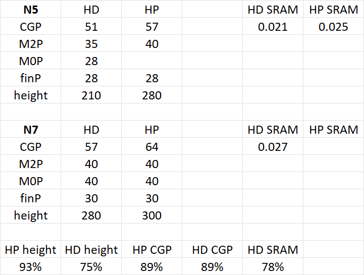

The high-performance design rules are also relaxed relative to high-density. So density trends should only be used with same cell types.
The cell scaling from N7 to N5 is as below:
Contacted gate pitch and cell height can be used to calculate the respective density increase.
Using the HD cell size, the N7 to N5 is density increase is 1.49x.
Using (HD) SRAM, 1.29x.
Using HP cell size, only 1.2x (cell height going from 300 nm to 280 nm).
Going from double to single diffusion break can bring an additional density enhancement.

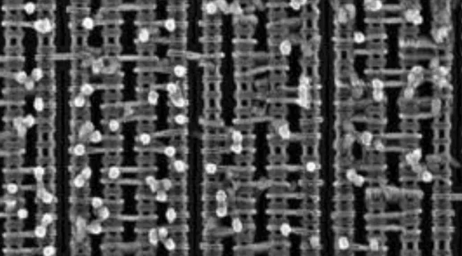

There was an interesting shot of the 210 nm x 51 nm cell:
It looks like for this part, the S/D nodes (each covering 2 fins) are on a 105 nm x 51 nm grid. The S/D-contacting and gate-contacting lines can approach each other really close, but there is a 105 nm space between S/D-contacting lines or between gate-contacting lines.

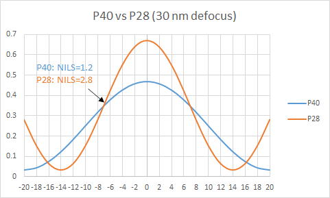

Forgot to estimate the effect of defocus, assuming the perfect binary images:
