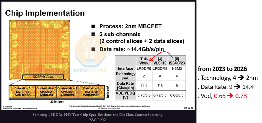

Samsung SF2 LPDDR6 PHY at 2026-Feb-ISSCC
. from 2023-ISSCC to 2026-ISSCC, Technology 4nm FinFET to 2nm GAA, Data Rate 9 to 14.4 Gb/s/pin
. But, Vdd 0.66 to 0.78, is this (not decrease but) increase for pushing up Date Rate?
. source = https://newsletter.semianalysis.com/p/isscc-2026-nvidia-and-broadcom-cpo
