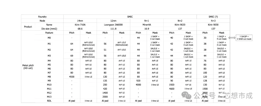

In 14nm/12nm processes, the first layer of BEOL is M1. Its characteristic is that its metal line direction is in both the X and Y directions, like the M1 in Samsung's 8nm process shown in Figure 2.
Generally speaking, from the emergence of 7nm to the present, the first layer of BEOL is M0, and each metal line is unidirectional and perpendicular to the next layer, as shown in the figure. However, before 7nm, the first layer was M1, which combined both horizontal and vertical directions.
As can be seen, the process methods used for each layer of 14/12nm are different. Because it is necessary to take into account both directions, including the process development time, the first three metal layers of 14nm use pitch split double exposure LELE (litho-etch-litho-etch) instead of SADP+cut mask.
At 12nm, the first layer M1 at 56nm still uses LELE, but theoretically, with M2 at 51nm, it should be close to the edge of using triple-exposure LELELE. However, the 12nm M2 is changed to unidirectional, and the first layer of BEOL usually has the highest layout complexity (e.g., tip-to-tip spacing requirements or pattern types). Therefore, although the pitch of the second layer M2 reaches 51nm, it can still use LELE.

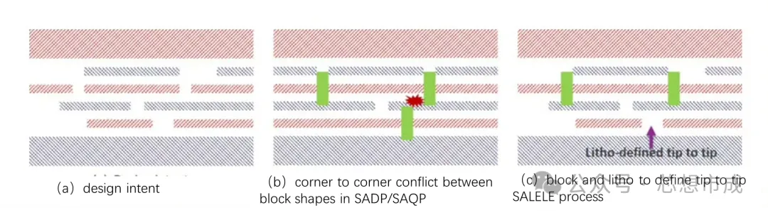

PS. Traditional SADP/SAQP, while achieving a very dense pitch with only one exposure, requires an additional cut/block mask for each breakpoint, regardless of its size. This can sometimes lead to issues with insufficient breakpoint spacing, necessitating mask splitting, even for large breakpoints.
SALELE, on the other hand, achieves double the pitch through two LELE exposures, while SADP only requires one. Its advantage over SADP is that if the breakpoint size requirement is not high, it can use the LE process itself to create the breakpoints. Therefore, even with small breakpoint requirements, the additional cut mask may not encounter breakpoint spacing issues requiring mask splitting (see Figure 4).
PS2. However, the SALELE method described above is a traditional approach. The difference between this type of salele and LELE is that Line 1 has a spacer, making it self-aligned. Its dimensions are protected by the spacer. Even if Line 2 has issues with the OVL or alignment of Line 1, it doesn't matter, as the space between Line 1 and Line 2 is defined by the spacer. Therefore, it's an improved version of LELE. (As shown in Figure 5, even though the light green Line 2 is almost touching the light blue Line 1, the actual spacing between lines after processing remains the same as the target value, defined by the Line 1 spacer.)
Unlike SADP/SAQP, this type of salele's spacer doesn't define the line pitch. Its pitch capability is derived from the pitch breakdown of LELE; the spacer is only used to protect Line 1.

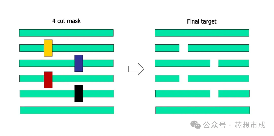

A detailed explanation is shown in Figure 6. Considering the pitch and tip-to-tip resolution of the cut mask pattern, the M0 of complex breakpoints needs to be split into four masks: cut mask 1, 2, 3, and 4. However, if the lines in the diagram become those in Figure 7 (different colored lines represent different etching resistance), then the number of cut masks needed to create the same breakpoint as in Figure 6 can be reduced to two. This is because the lines that can be etched are different when cut masks 1 and 2 are opened respectively, so the M0 layout with the same complex breakpoint can be obtained in the end.

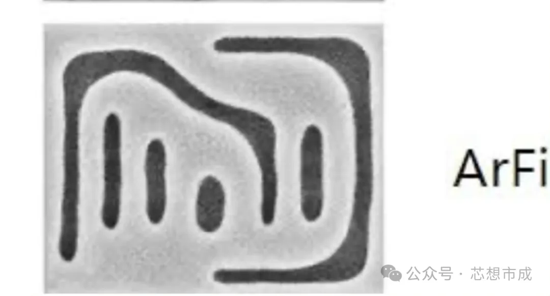

However, as you can see in the red box in the image below, the breakpoint shape looks very poor. This is because when the main pitch is reduced, in order to avoid cutting where it shouldn't break, the size of the mask to be exposed needs to be reduced, as shown in the image below. But reducing the immersion size will cause problems. Even if you want to make a rectangular pattern, when the length is reduced to a shorter rectangle, the actual exposed pattern will look like an ellipse or even a circle, such as the left side of Figure 11. This part is irrelevant no matter how OPC modifies the mask shape. Then, circular cuts will have potential problems, such as cutting out horns like the upper right diagram in Figure 11, or even cutting at an angle due to OVL displacement. This part may cause subsequent electrical or yield problems.
SAB cut can alleviate this problem because, as we mentioned above, different etching options can be used to make the cut mask pattern larger. This allows for a long, straight cut, as shown in the lower right diagram, ensuring that the cut size and shape are as expected.

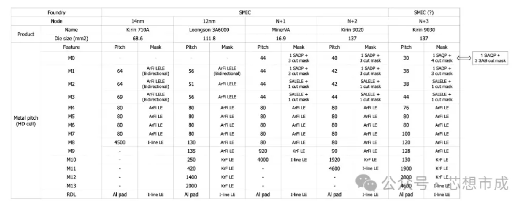

Therefore, based on the above analysis, the M0 process of N+3 is divided into a pessimistic version with 5 exposures and an optimistic version with 4 exposures. Finally, let's return to the remaining M1/M2/M3 processes of N+3.
Although M1/M2 have the same 38nm pitch, the N+3 chips cut this time show that M1, like N+2, has very dense small-sized breakpoints. Its process is judged to be 1 DUV SAQP + 3 cut mask quadruple exposure. While M2 also has a 38nm pitch, the breakpoint size is larger and more spacious, with small breakpoints present but spaced far apart. Therefore, the process is judged to be SALELE + 1 cut mask triple exposure. Finally, the situation for M3 is the same as M2, with the process also being SALELE + 1 cut mask triple exposure.
