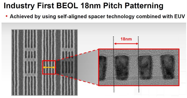

In 2020, TSMC showed M0 18nm. When for HVM, 2030 (or never)?

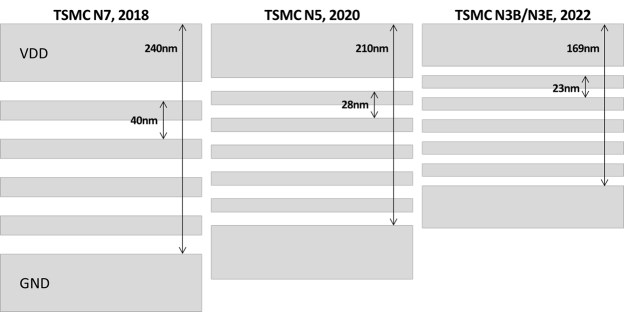

At 2022-Dec-IEDM, TSMC presented M0 23nm with "an innovative liner". In 2024-Jul, Applied announced RuCo liner, not needed for Intel? Link = https://ir.appliedmaterials.com/new...s-unveils-chip-wiring-innovations-more-energy
At 2025-Jun-VLSI, Intel showed same CPP 50nm from Intel 3 to Intel 18A. Like this being pragmatic/realistic.
Why backside power for Intel Foundry? Since not competitive against TSMC for Cell Height without it! Since for M0, Intel 18A 32nm vs TSMC N3B/N3E 23nm.
