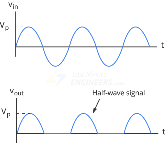

They both are wave form shaping... but not in the same way. However you can turn a clipper into a half wave rectifier by clipping all of the negative signal but none of the positive. See below:
Signal clipping
vs
Half wave rectification
