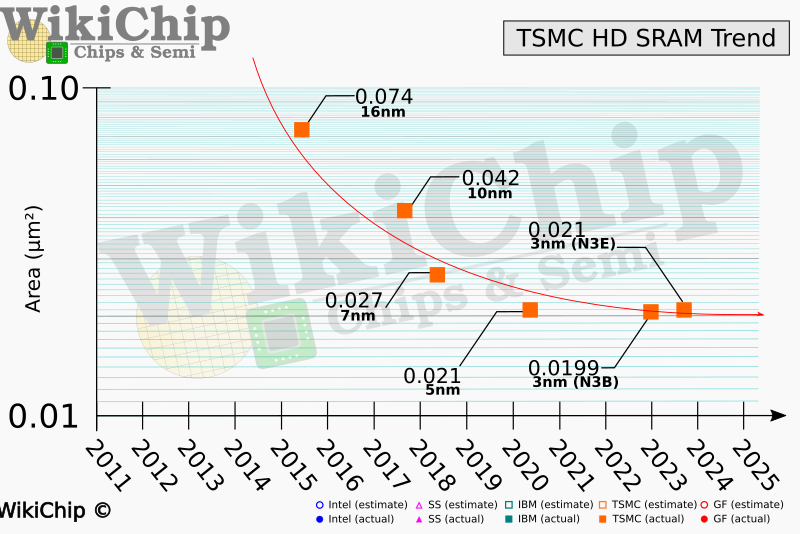

The implication of Finfet SRAM non-scaling is huge. SRAMs are just regular transistors, no capacitor. The SRAM test chip is what is used to describe MMP and CPP and tracks, meaning it is descriptive of the entire node, and generalizes to the entire node. So the inescapable conclusion is that Finfet scaling has hit a wall. A wall we all knew was there, physics, our old friend.
This helps explain why Samsung went with GAA. Maybe if you want dense SRAMs, you need to be talking 3nm with Samsung. Memory is the main business there after all.
