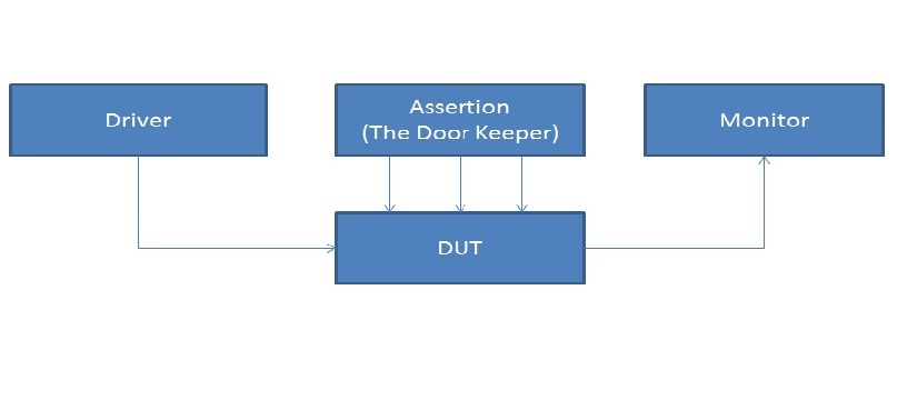

Assertions are usually connected to the DUT (Design Under Test) through interface and keeps continuous eye on activities per clock. This way it is making sure that nothing bad happens, if so, it will inform user that something went wrong on particular clock. Simulation tools are also intelligent in different ways (through log dump, GUI dump etc…) to report assertion failures! In SVA there are two types of Assertions, 1. Immediate and 2. Concurrent Assertion. (For more details on assertions please see blog on ‘coverage model in system verilog’)
