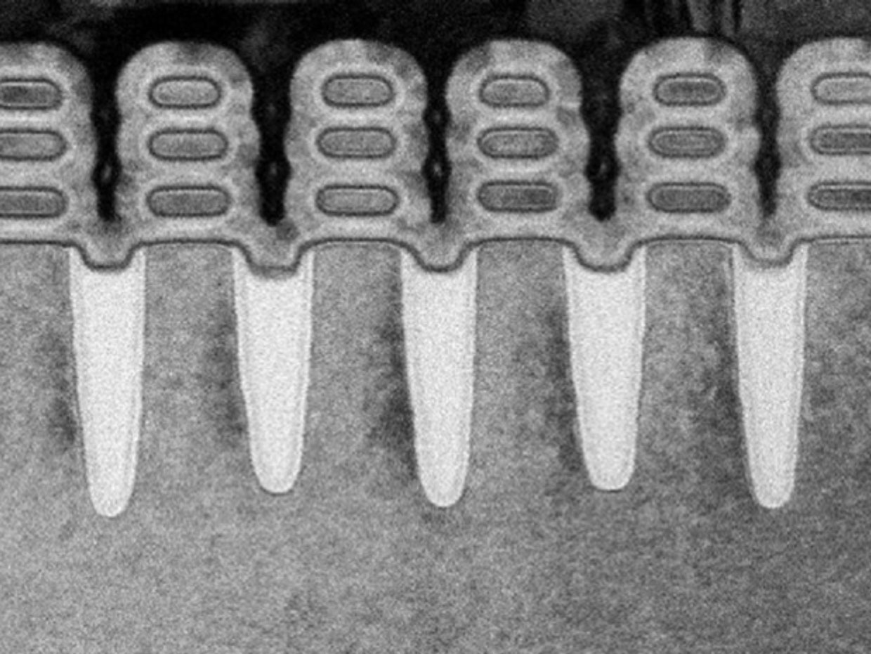

The Shape of Things to Come: Nanosheet field-effect transistors flow current through multiple stacks of silicon that are completely surrounded by the transistor gate. The design reduces avenues for current to leak through and boosts the amount of current the device can drive.
