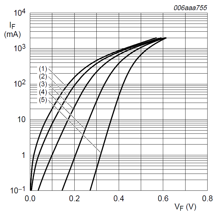

I'm trying to model the forward voltage of the Nexperia PMEG4010CEH Schottky diode, shown in this graph, for some circuit analysis.
The -40 C / +25 C / +85 C curves fit a model of (ideal diode in series with resistor) very well, that is, Vf = kT/q * ln(I/Is) + IR, within a few millivolts, better than I expected. But the values of R and Is change with temperature, and I'm not familiar with diode models enough to understand what's going on here and see if it matches theoretical physics / materials science, or whether there are empirical differences.
-40 C: R ~ 72 milliohms, Is ~ 0.2 nA
25 C: R ~ 103 milliohms, Is ~ 430 nA
85 C: R ~ 146 milliohms, Is ~ 35 uA
What should I expect from this kind of diode? Is the resistance likely due to the metal terminals, or the silicon, or some other phenomenon? What about Is variation?

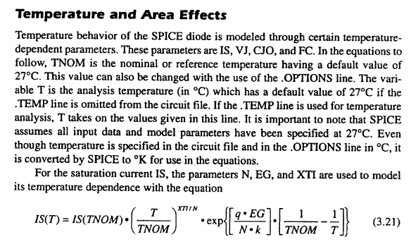

hmmm.... maybe I spoke too soon....
The temperature dependence of the saturation current is defined by the parameters EG, the band gap energy and XTI, the saturation current temperature exponent.
and https://ltwiki.org/files/SPICEdiodeModel.pdf
so if I plug the SPICE parameters into the equation, I get:
-40 C: Is = 5.25e-11
25 C: Is = 2.29e-07
85 C: Is = 3.8e-05
which isn't too far off from my numerical estimates.
