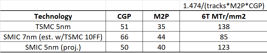

SMIC mainly needs to shrink gate pitch to get to ~10% shy of TSMC's N5 transistor density. Shrinking the metal pitch aggressively (<40 nm) with more extensive multipatterning probably not worth the effort.
The transistor density formula and TSMC N5 numbers are from https://www.angstronomics.com/p/the-truth-of-tsmc-5nm The actual multiplier for the density might be indefinitely debated, but the proportionalities shouldn't be affected. SMIC's 7nm is estimated using TSMC N10.
