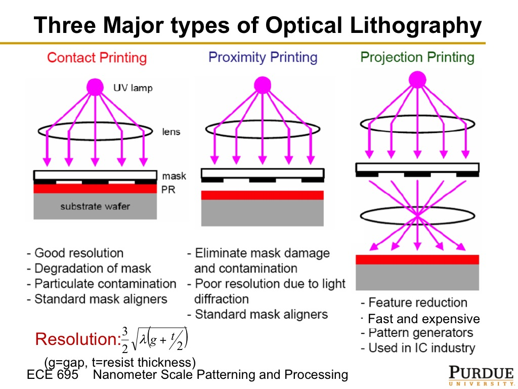

Is the reticle size chip @4X on mask?
Or is the chip really something like 4 or 5 inches across?
Current optical systems do a 4x reduction of the mask. So a reticle sized die is 1/4th the size of the mask.
Random image I found from Purdue. As for why 4x reduction is the limit of projection optics (if we ignore high-NA's 4x by 8x), I have absolutely no clue. Optics and waves were always my weakest physical discipline; but I work in etch, so that is fine by me. ;)

Thanks , was thinking actual reticle size chip would be quite mighty in size!

The 4 to 1 reduction allows the design of masks to be more relaxed and detailed than the final image. The mask can be made as precisely as the wafer, even more precise using ebeam lithography for mask writing, and then the fuzziness is (simplifying) only at the wafer, no additional losses due to difficulties at the mask. 4 to 1 is simply a compromise between making the mask large enough to get that clarity advantage, but an even higher ratio would make the lenses even more massive and expensive.
More than you ever wanted to know about lenses from David Shafer. He references his work for Zeiss beginning around slide 55 of this restrospective slide set: https://www.slideshare.net/operacrazy/highlights-of-my-48-years-in-optical-design

Stitching multiple reticles is also difficult, there tend to be scattered light effects at the edge of the mask. These are fine if that is the edge of the chip, but problematic if you want to make a seamless join. Companies like Nikon provide specialized scanners that can draw higher level wires to join multi-reticle chips, where if you look deeper in the finished chip you will find an empty gap at the lower levels.

Thanks , post mask is not my area of knowledge , so its always interesting to read here and get answers from those with the knowledge of mask usage
