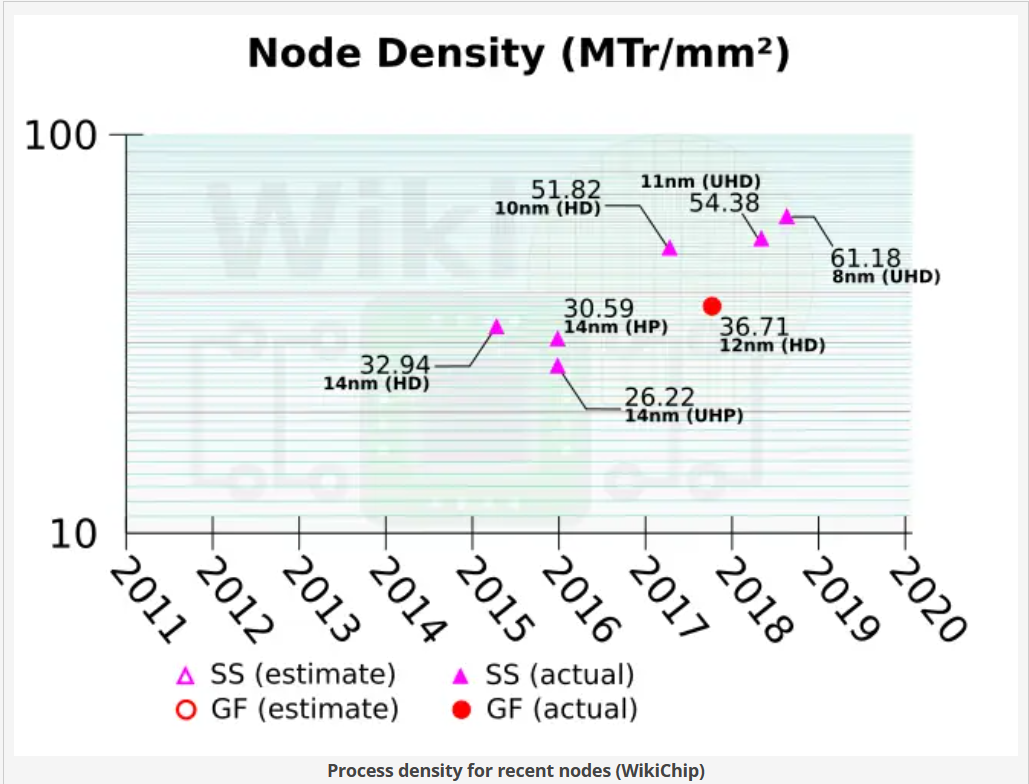

From this blog, IBM said 22 billion transistors in 800mm2 using 12nm nodes. The transistor density will be ~27.5Mt/mm2 for HPC application. I bet it more likely will be in GF.800 sq mm is one die per reticle, I think. Not small
