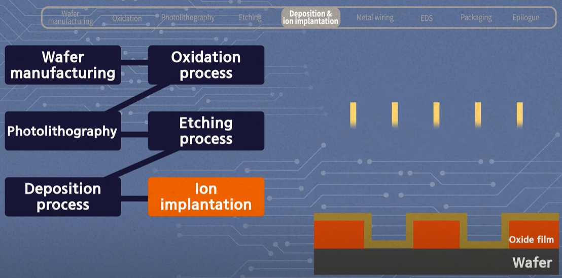

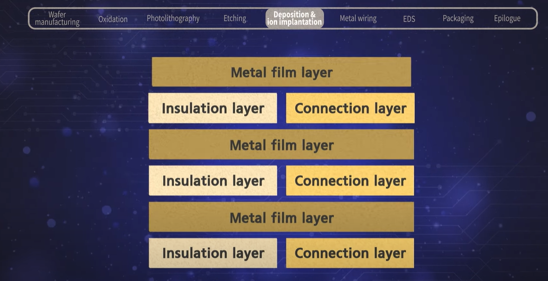

I saw on YT a video from Samsung, explaining the process:
In this picture, they show that the ion implantation comes after the deposition process? Isn`t this wrong? In this case the n-doped area of Silicon would be above the metal layer? This makes no sense to me? Besides this, in the schematics bottom right, there do not show the p- and n-type area in the wafer.

Hi, I see a major problem in your pdf: in step 7, n-doped silicon cannot magically appear in the voids of step 6 (certainly not as a consequence of PR removal). As a matter of fact, in step 6 there is no reason to etch away that bit of silicon below the oxide. Doping (typically performed by ion implantation) does not add silicon to the wafer, it puts dopant atoms INSIDE the silicon that's already there. Basically you launch high-energy atoms towards the exposed silicon, they enter the silicon, lose kinetic energy and finally stop a few nm (or even hundreds on nm, depending on the energy) inside the silicon. When you do an ion implantation, you protect the silicon (with PR or oxide or whatever) where you DON'T want doping.

Ok, understood. So the etching does not remove the Silicon but only the oxide layer above.
The n doping in this specific area (which at the end is the drain and source area) come from ion implantation.
