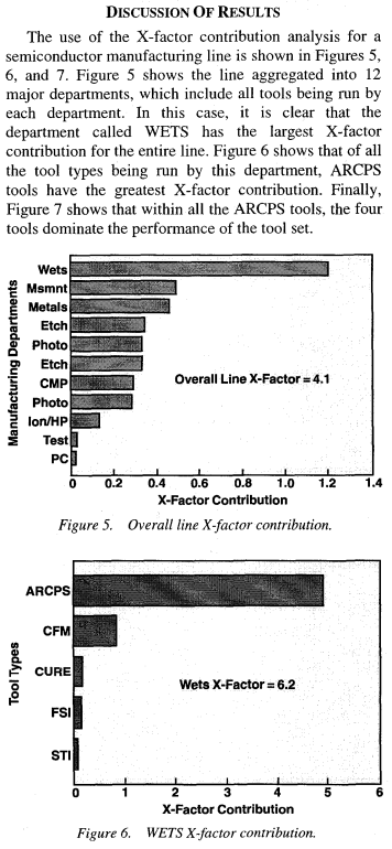

The only tangible hints I found were in a 1998 article by Donald Martin from IBM (https://ieeexplore.ieee.org/document/731385) which mention "a six-hour furnace operation" and "20-minute ion implant" as hypothetical examples (and later another hypothetical furnace step with "a raw process time of four hours") and this section on major contribution to X-factor, where "WETS" perhaps = wet bench.

What are the longest steps in the fabrication process? furnace anneals?
...and why would wet bench have a long queue / high variability?
