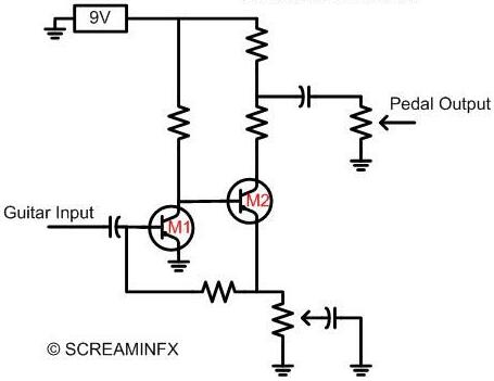

I'm kind of a newbie with electronics but I do know some how to differentiate the two. But in this there aren't any of the common markers. If I had to guess it would be NPN from NPN Transistor Arrangement and Symbol Basic but I can't be certain. If someone more experienced could help me out that would be great.
Also, if there are any guitar pedal guys out there, does the pot control the overall fuzziness of the circuit?
Any idea is appreciated. Thanks in advance.
The transistors should be NPN (you drew PNP). We usually use Q as the component designator; M is more commonly used for MOSFETs.
I'm not a guitar pedal person, so don't know what fuzziness means. The pot would control the frequency at which the gain is increased.
The capacitors on the right have their polarity reversed.
They did not draw the polarity of the 9V battery either, so it is possible to do this circuit with PNP if the top connects to the negative of the battery. That would explain the capacitor polarity too.
As DL324 says, that pot at lower right controls the increase at high frequency, which would be where it limits as square wave fuzz. That looks like an old circuit. 9V seems a little high for generating square waves these days, but maybe the more robust signals work better on stage.
