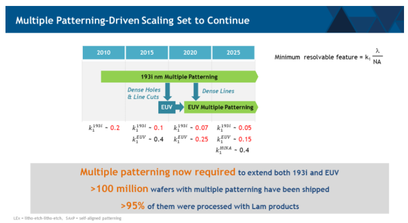

Lam Research claims over 95% of the more than 100 million wafers processed with multipatterning (193i and EUV), particularly highlighting 5nm logic node.

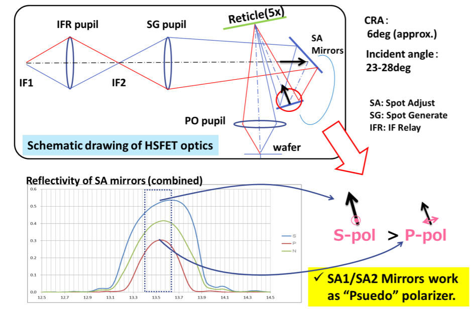

It seems polarization is something they possibly want to control for high NA EUV: https://www.spiedigitallibrary.org/...zation-effects/10.1117/12.2599904.short?SSO=1
The normalized image log-slope (NILS), the key image quality metric, was found to fall below 2 for 16 nm half-pitch, when using unpolarized, but improved above 2 by using the suitable polarization (parallel to the lines). So there is a thought to use multilayers specifically for polarization. It also entails maybe two exposures, one for horizontal lines, one for vertical lines.
An earlier study by EIDEC confirmed the partial polarization effect: https://www.spiedigitallibrary.org/...Field-Exposure/10.1117/12.2219368.short?SSO=1
It can also be accessed here: http://euvlsymposium.lbl.gov/pdf/2016/Poster/P-EE-06.pdf
The partial polarizing effect is shown in the excerpt below.

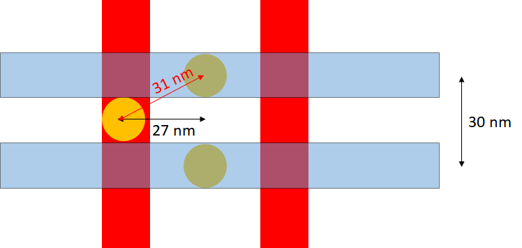

My understanding was that 5/4nm already had some EUV multipatterning and 3nm even more. For something like SALELE for the metal layers, it would be 4 masks. The center-to-center for contacts could be less than 30 nm, requiring triple patterning. Perhaps for TSMC, the multipatterning barrier is less of an issue, since they've done it for a long time already.
