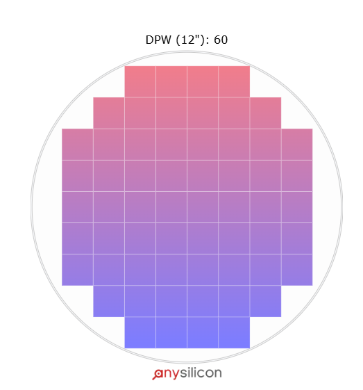

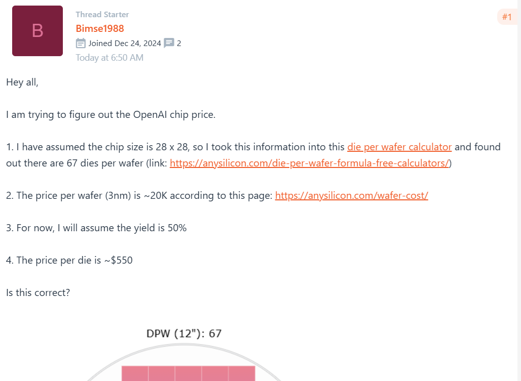

Hey all,
Again its me with the same price exercise!
I am trying to figure out the OpenAI chip price.
1. I have assumed the chip size is 30x30, so I took this information into this die per wafer calculator and found out there are 60 dies per wafer (link: https://anysilicon.com/die-per-wafer-formula-free-calculators/)
2. The price per wafer (3nm) is ~20K (assumption)
3. For now, I will assume the yield is 50%
4. The price per die is ~$600
Is this correct?
5. will the package cost the same? e.g $600
Thanks in advance for your answers

Is there any particular reason you assumed it's 30x30 per chip?
