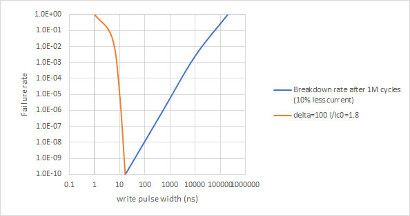

Moreover, accumulated write pulse time can increase the probability of breakdown:
More discussion here: Breakdown-Limited Write Time Windows for STT-MRAM
