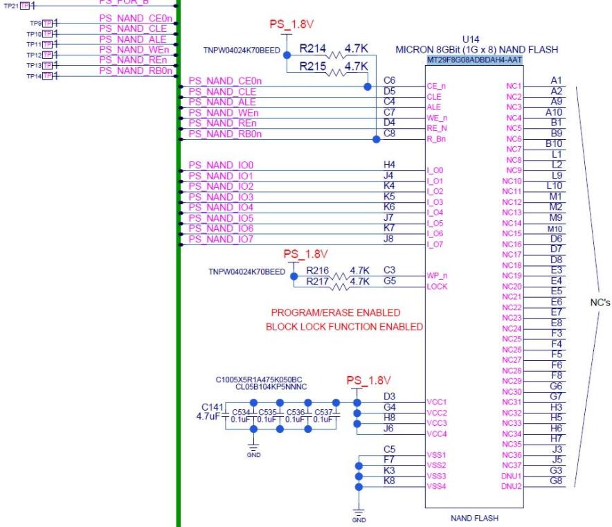

Hello, all
I am using the Zynq Ultrascale+ MPSoC on a custom board and have an 8bit NAND Flash memory to boot from. When I try to program the Flash using the Vitis Program Flash Memory tool I am able to measure the CE pin and it does go low and high so I believe the tool is trying to program the NAND flash but in the Vitis Console window it show 8 bad blocks and fails to successfully write data. The part number of my device: MT29F8G08ADBDAH4-AAT
How do determine if the memory I have is compatible with the Vitis Program Flash Utility? 😕
