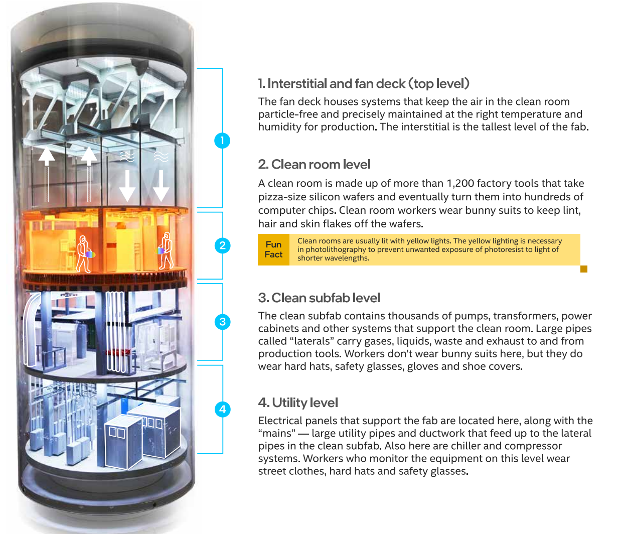

Cleanroom space in a fab is expensive space, while support areas are cheap, so taller, to me, equates with more support space, rather than more cleanroom.
It could mean a second cleanroom level, stacked, but I tend to discount this possibility.
More support space per unit of cleanroom space is an ongoing trend. You could readily imagine that each tool in the latest Kioxia fab will have more gases/chemicals or more chambers, or both, in each tool, which in turn is multiplicative in the support below, which is what drives the taller profile, as cleanroom space remains relatively constant but chemicals proliferate like mad.
"One thing you will notice when you go into a fab is also how tall it is. These buildings are designed to be autonomous but also easy to maximize uptime. That means if something fails (like a ceiling light), it can be repaired without disabling anything. Even the ceiling lights have access from above the fab if they ever need to be repaired or replaced. But the reason why the fab area is so tall is because some of the machines are two stories high, especially the EUV machines. Sometimes these have to be lifted in, or use reinforcement beams to install them. It’s quite hard to miss."
Having a subfab/utility level and air circulation above the clean room is hardly unique to NAND though. It would also strike me as odd that Kioxia would have way more chems and gas lines then a logic fab. Given they use many of the same tools (admittedly in different ratios from DRAM and logic) you would think that those requirements are similar. If anything given the more complex structures being formed you would expect modern logic fabs to have even more difficult subfab/utility routing.
Agreed on the two clean room levels sounding unrealistic though.

It seems like intel and TSMC fabs have large utilities buildings next to their fabs. Meanwhile in the pictures of the Samsung and Kioxia fabs there seem to be fewer (and sometimes no) utility buildings visible. It also seems like there is more exhaust chimneys for the Samsung fabs than the TSMC or intel fabs. This might indicate that rather than having just a subfab and a utility level, maybe Samsung and Kioxia design their fabs with multiple utility levels to avoid having to "waste space" on separate utility buildings. If I had to hazard a guess on an arrangement I would have the intergraded utility building stuff on the first floor, then either the subfab or traditional utility level, clean room, fan deck, and at the very top either the subfab or traditional utility level (whichever is lighter). Although maybe I am overestimating how heavy tools can be, and maybe it is fine if the cleanroom is on the 4th floor rather than the 3rd. Given the fact they need to eventually get exhaust out the top, maybe the integrated utility building might actually be the top floor (assuming the building can be made tough enough to support that weight that high up).
