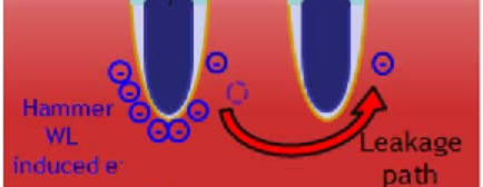

NAND never really used EUV since its patterning is basically lots of straight lines and now they have gone to 3D.
Although some EUV use has started at some DRAM companies, how far will it take them? Probably not much, since there are other issues limiting the scaling. Essentially, the buried word line pitch is severely sensitive to Rowhammer.
