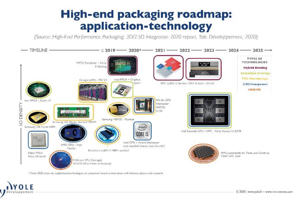

This report from Yole might help answer part of your questions. Besides, tsmc announced ~10% of 2021 CapEx($25-28B) will be in advanced packages. Not sure how much will intel spend in his $20B CapEx for advanced package foundry.

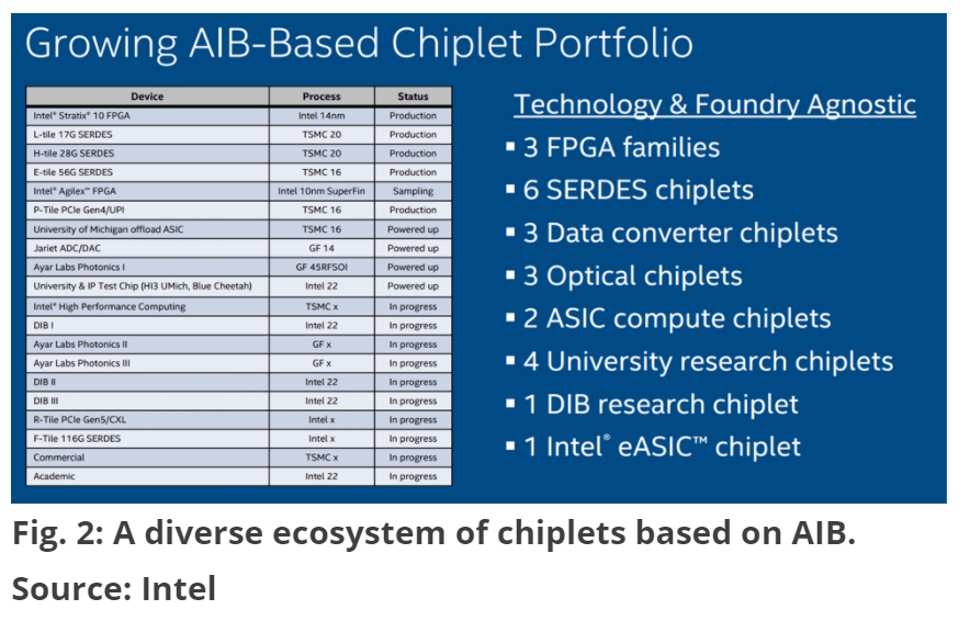

I'm not positive, but I think Intel already uses TSMC for foveros like parts and HBM with Samsung for emib

This answers your question. Yes, intel does use tsmc chips in chiplet portfolio.
