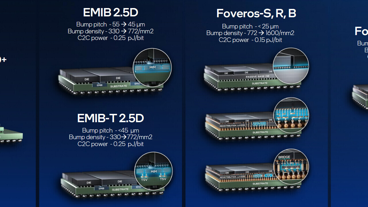

If the performance requirements for new AI or HPC tasks demand maximum performance density regardless of power or heat constraints, Intel has a project presentation scheduled for the ISSCC conference in February 2026. One of the topics will be a 5,000 W GPU design utilizing integrated voltage regulators (IVRs). While this may seem extreme, Intel plans to leverage advanced packaging technology, specifically the Foveros-B variant, to deliver 5 kW GPUs by 2027. As accelerators scale to support larger AI and HPC workloads, traditional board-level regulators are hitting limits in current density and transient response.
Moving voltage regulation into the package shortens current paths and reduces delivery losses. Intel Foundry and its packaging division are already exploring high-density power delivery and kW-class integrated voltage regulators. Intel's Foveros roadmap targets production-ready integrated power elements by 2027, enabling customers to evaluate IVR-enabled assemblies at scale very soon. While Foveros-B is a 2027 product, customers could potentially evaluate multi-kilowatt designs with IVRs next year. Intel is not a singled-out player with multi-kilowatt designs, as NVIDIA "Rubin" silicon is rumored to have a TDP of up to 2.3 kW for highest-end models, leading to rack-level power consumption exceeding 250 kW.

Foveros-B will place regulator on separate die which will help with transistor arch differences, wonder how will it improve other points.
