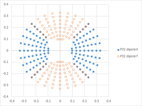

The SPIE paper 1229202 talks about bidirectional direct print for flexibility, but at their reference 32 nm pitch, there is essentially no pupil space for supporting bidirectional.

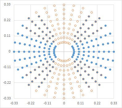

A unidirectional pitch would need cuts generally; for the 0.33 NA you would need to be about 36 nm pitch to get bidirectional.

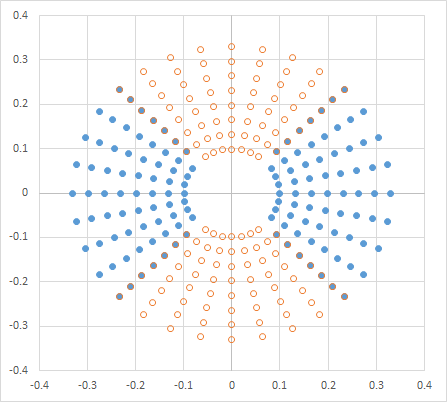

34 nm pitch still similar to 32 nm (negligible overlap between X and Y):
