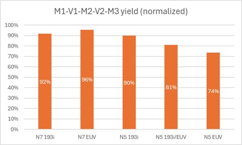

As semiconductor industry transitions to EUV lithography in advanced technology nodes, EUV stochastic defects play a significant role in chip yield degradation. Present yield models do not account for the stochastic-driven defects that changes by both pitches and critical dimensions (CD) in EUV lithography. In this study, a novel approach that incorporates EUV stochastics into the yield modeling, using calibrated stochastic defects from wafer data is introduced. Then a comparative analysis of yield for various EUV insertion scenarios is meticulously performed. Additionally, strategies to enhance yield in EUV lithography, including CD retargeting are proposed.

Just read this paper, it turns out they are calibrating to previous papers' assumptions of defect density, but the trends they got were as expected.
