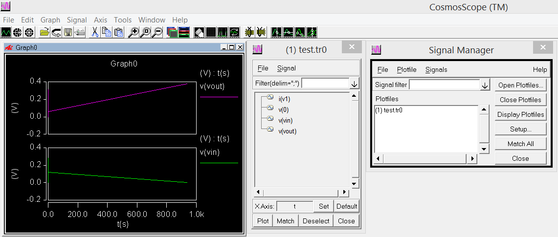

I am new to HSpice and simulating a simple voltage divider , the netlist is as follows,
Code:
*** TOP LEVEL CELL: R_divider{sch}
R0 vout vin 10k
R1 0 vout 10k
* Spice Code nodes in cell cell 'R_divider{sch}'
v1 vin 0 sin(0 5 1k)
.OPTIONS LIST NODE POST
.tran 1u 5m
.print tran v(vout) v(vin)
.END

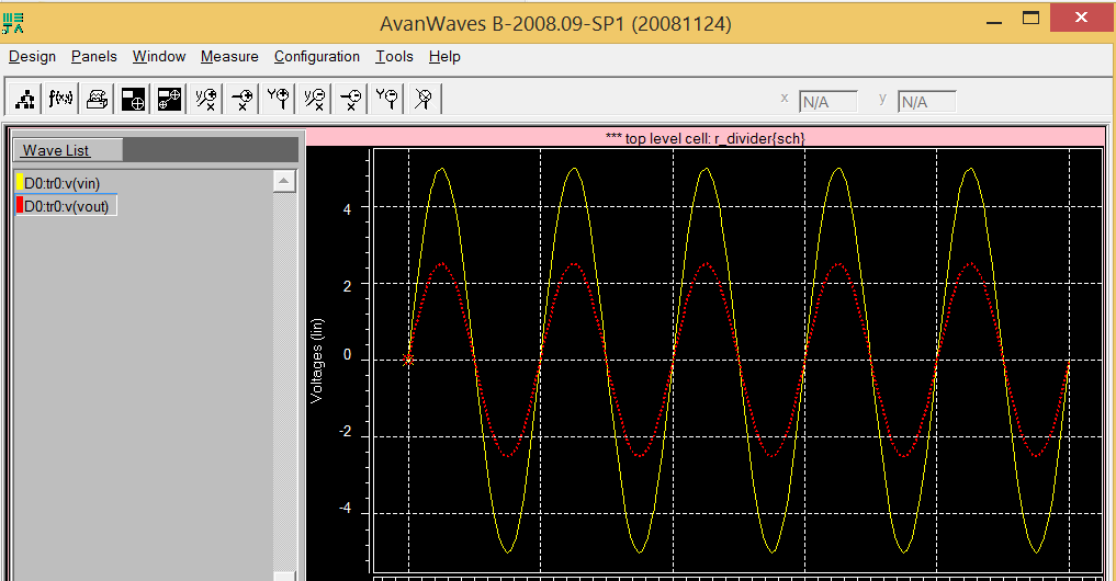

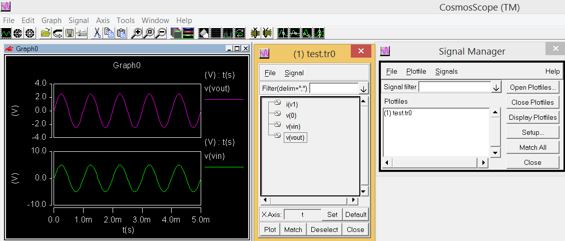

when I simulate it using HSPICE J-2014.09-SP2 all is well, output is coming as expected in CosmosScope
also in avanwaves output is coming as expected,
but in my another lab where HSPICE L-2016.06-SP1 is installed, simulating the same netlist with HSPICE L-2016.06-SP1 output on cosmosScope is comming like this,
I thought it is x-axis scale problem but after scaling the x-axis,

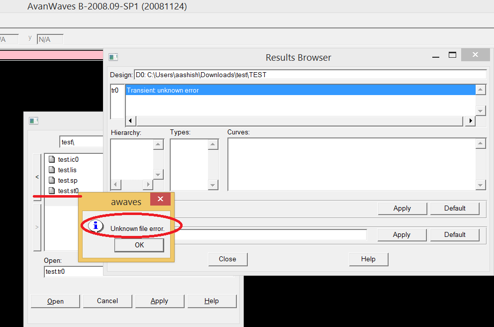

on avanwaves when i try to open the .tr0 file it gives error,
I am unable to figure out what is happening,
please help me
Actually I have to work in the new HSPICE L-2016 so please help me getting the correct output.
thanks in advance
thanks
Time to call the local AE and file a bug report with Synopsys. Somehow it looks like the .tr0 file got corrupted. Can you re-run the simulation using a different output file name and see what happens?

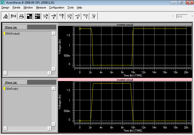

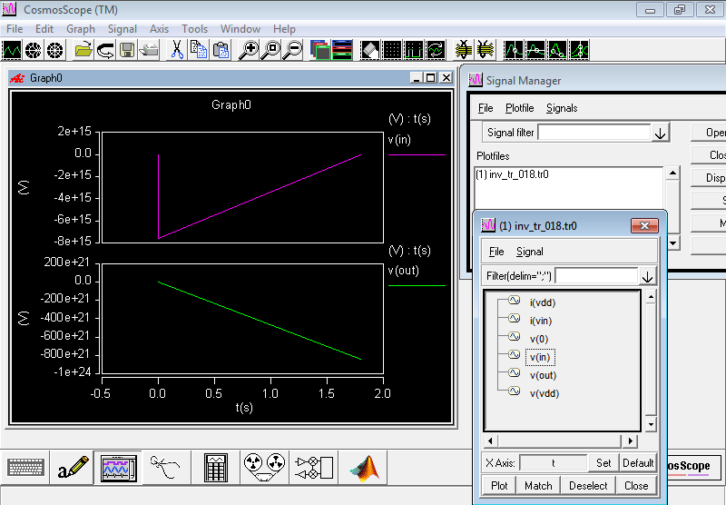

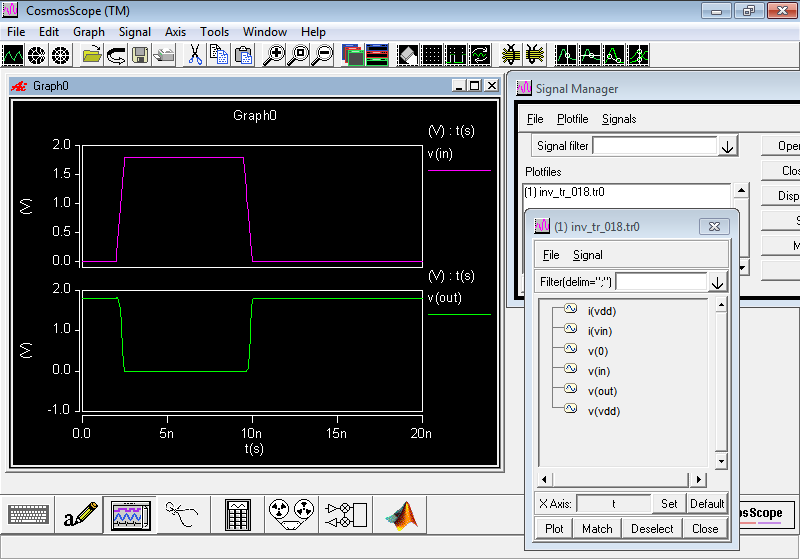

Thanks for your reply, I also tried a simple CMOS inverter, the netlist is as follows,
Code:
Inverter Circuit
M1 OUT IN VDD VDD CMOSP L=0.18u W=1.8u
M2 OUT IN 0 0 CMOSN L=0.18U W=0.9U
VDD VDD 0 1.8
VIN IN 0 0 PULSE 0 1.8 2n .5n .5n 7n 20n
CLOAD OUT 0 20fF
.TRAN 200p 20n
.PRINT TRAN V(IN) V(OUT)
.LIB "tsmc_018um_model" CMOS_MODELS
.END
again the same story repeats,

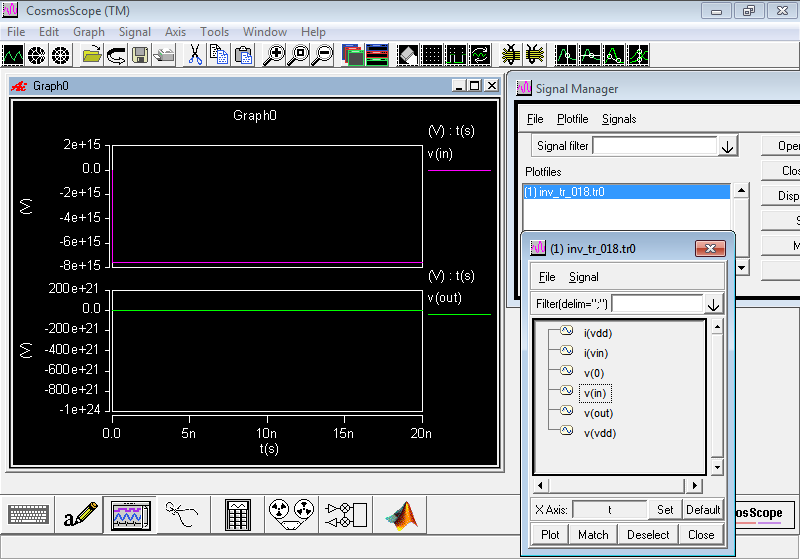

even on changing the x-axis to (0 to 20n) the output is,

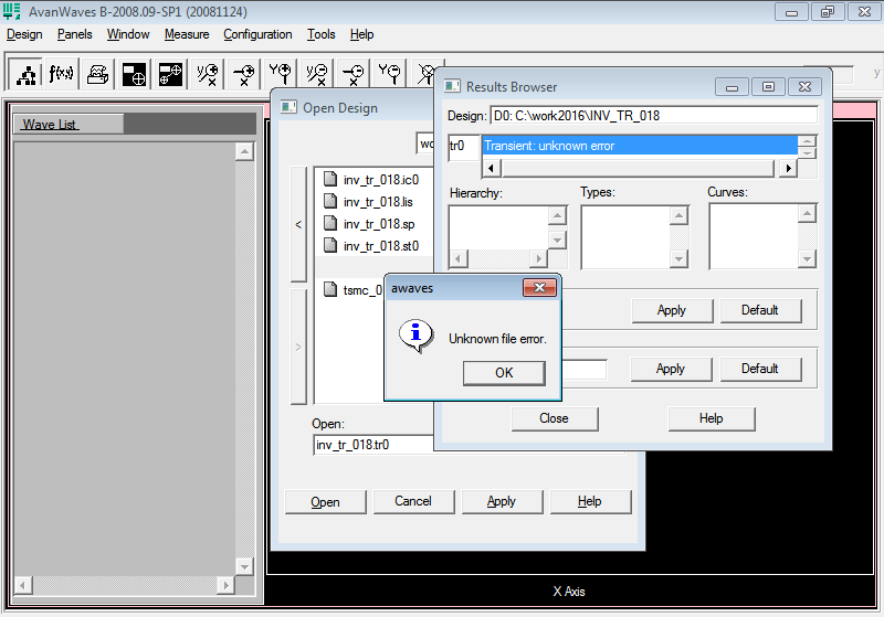

I have tried changing different filenames, different file locations, license server restart, pc restart etc.... but no luck.

Hi ashueda
I work at Synopsys and I would like to help. I ran a few tests and it seems like the problem is with CScope. This issue is present in the 2015 version of CScope, but it has been resolved in the 2016 and later versions.
Do you have the ability to use a newer version of CScope, or request an upgrade to a later version? Or perhaps use a different waveform viewer, such as Custom WaveView (which is the default waveform viewer we recommend for analog waveforms).
If you require technical assistance, please also try SolvNet at http://solvnet.synopsys.com, or contact the Synopsys Support Center at 800-245-8005.
Thanks for your reply but as far as I think it is not the problem of cosmosscope, because the .tr0, .sw0 files produced by the hspice2016 are not opening in any waveform viewer, I tried several waveform viewers say cscope, avanwaves, WaveView, gaw, gwave, etc. and the .tr0, .sw0 files produced by the hspice2014 are opening in every waveform viewer.
So it indicates it is not the problem of waveform viewers, it is the problem of hspice2016 simulator itself, it seems it is producing corrupt files.
You may want to try saving in fsdb format in HSPICE. Include the following line before the ".end" in your netlist:
.option fsdb=1
Besides that, I also sent you a private message with my contact info a couple of weeks ago. Feel free to reach out if this issue is still unresolved.
