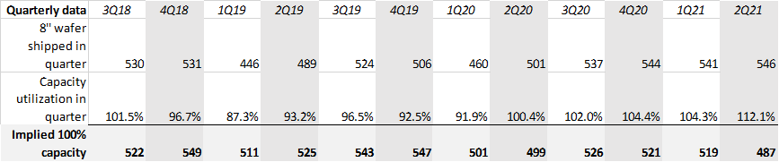

Thanks for the answers from everybody. So I checked the theory suggested by the first three commenters to find-out what the actual internal capacity is at 100%. I only did it for their 8'' fabs, since their 12'' fab is still ramping up, so I didn't want to introduce more room for error.
It was basic division, just divided the output from the quarter by the reported overcapacity. Here's the result for data going back to 3Q 2018:
I think the result is a bit curious, it indicates that their internal 100% capacity is unstable QoQ.
Mean implied capacity was 520.8K wafers/quarter.
Standard deviation of capacity was 19.4K wafers.
Thanks again for the input from all, looking forward to hearing more ideas.
