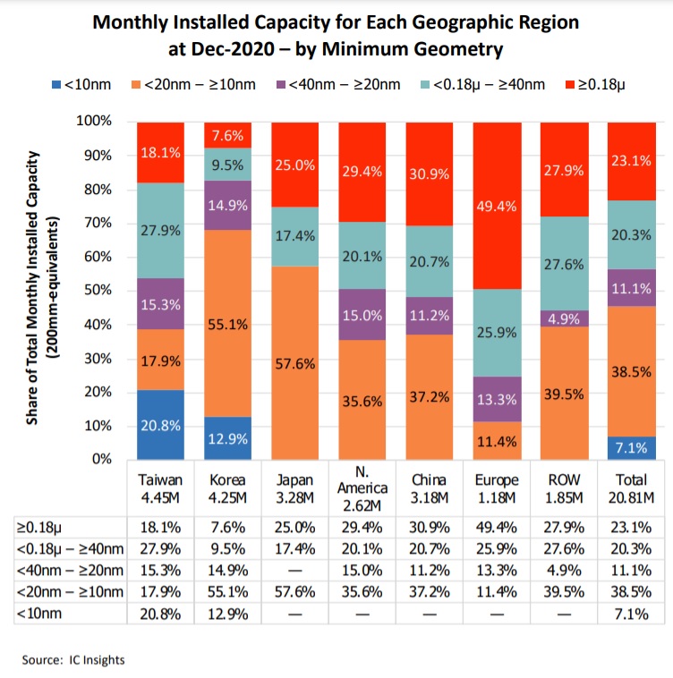

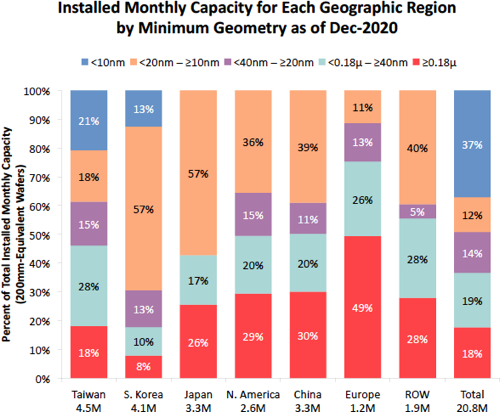

Taiwan has 21% <10nm installed capacity, Korea has 13% <10nm installed capacity and yet somehow, 37% of the worldwide total installed capacity is <10nm... it's like their one job is to put out correct data and they somehow screwed it up 🤦‍♂️
Should be 7% for <10nm, 39% for 10-20nm, 11% for 20-40nm, 20% for 40nm-0.18µ and 23% for >0.18µ for the total, they added 10-20nm figures from areas outside Taiwan/Korea to the cumulative <10nm figures to come up with 37%...

Yeah, I was also confused after looking at that chart. "But this doesn't add up!" 😅

Good point. I'm probably missing something and/or my math is completely wrong but the numbers don't add up at all:
For <10nm:
  • TW: 0,21 * 4,5M = 0,945M wafers
  • SK: 0,13 * 4,1M = 0,533M wafer
  • TOTAL <10nm: 1,478M wafers vs 7,696M wafers (0,37 * 20,8M)
Could someone point out where I'm wrong? :) The numbers for >10nm - <20nm don't make sense as well.

Yeah, I posted what the percentages should be for the global total:
7% for <10nm
39% for 10-20nm
11% for 20-40nm
20% for 40nm-0.18µ
23% for >0.18µ
Not even sure how they got their numbers, I tried calculating with my theory that they screwed up <10nm numbers by using 10-20nm proportions for the countries not Taiwan or Korea, but it still couldn't add up to 37% 🤷‍♂️
