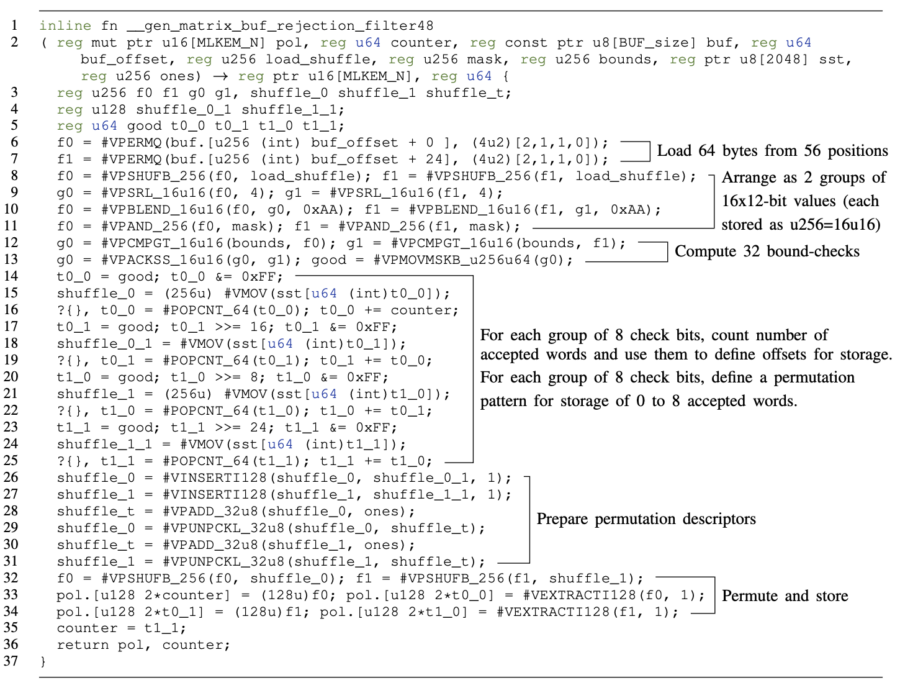

Assuming a pre-existing implementation of the SHAKE-128 XOF, implementing this rejection sampling procedure (and indeed, checking its correctness) seems straightforward. However, this assumption severely underestimates the creativity of cryptography practitioners in making the most of architecture-specific instructions to boost the performance of implementations. If we look at the AVX2 code for this rejection sampling routine in the available open-source implementations, we find a core routine that uses SIMD operations to batch-extract polynomial coefficients from the next 56-bytes in the XOF output in a fraction of the time taken by a naive implementation.
We reproduce below, a diagram of this code taken from [Almeida et al., S&P 2025] and refer the reader to the original text for a more detailed explanation and a discussion of the provenance of the ideas in this code.
Annotated Jasmin code for the ML-KEM matrix generation
In short, the code first reads 48 bytes representing 32×12-bit candidates from the input buffer and rearranges them in two 256-bit registers as two 16×16-bit sets. Then the code checks the validity of all candidates in parallel and computes a 32-bit value that represents all the results. Then the candidates are processed 8 at a time: for each set of 8 candidates, a permutation descriptor is retrieved from a memory table (there are only 256 permutations for each set of 8 candidates). The selected permutations will place the accepted candidates on the left of each 256-bit register. Finally, the code computes the permutations, counts the good candidates in each set, and places them in the correct position of the output buffer.
This particular implementation is given in the Jasmin programming language, but the code itself can be thought of as assembly or a sequence of intrinsic calls in C as in the implementation available from the CRYSTALS-KYBER repository. Jasmin was particularly designed with formal verification of architecture-specific assembly code in mind. Specifically, in addition to certified compilation from Jasmin source to assembly, the Jasmin tool-chain enables extraction of a model of the program to the EasyCrypt proof assistant, where it can be analysed for arbitrary properties.

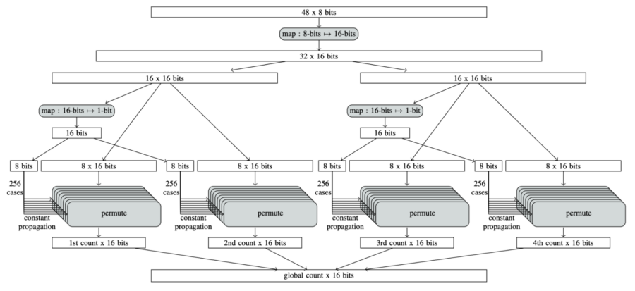

Downwards, the first step in the computation is expressed as a map computation from an array of 12-bit words to 16-bit words. In the original program, these 12-bit words are opaquely stored inside the input byte array. However, at the circuit level, one is free to choose any word size! This is one of the features of a new circuit-based reasoning backend that was added to EasyCrypt. Indeed, the proof that the 12-bit candidates are unpacked correctly to 16-bit words by a sequence of SIMD permutation instructions, is trivial once it is expressed at the circuit level.
Next, the computation of the range-check-bits for the 32 candidates can again be seen at the circuit level, as a map computation, now, however, mapping 16-bit words to 1-bit words. The computation in this case is slightly more complex, as it is not merely permuting the input bits. In this step, the proof showcases another optimization of circuit-based reasoning that was added to EasyCrypt: the ability to check the correctness of map computations by confirming that the circuit representing the implementation decomposes into parallel lanes, which are all functionally equivalent to each other (in fact they are syntactically identical, which means that the proof is usually trivial). As a result, functional correctness can be checked only for one of the lanes at a fraction of the cost.
Finally, in the most intricate part of the proof, the code uses memory tables for storing permutation descriptors. A naive implementation of circuit-based reasoning in this step would explode in complexity due to the need to encode data-dependent table accesses. However, by using the deductive reasoning in EasyCrypt, it is possible to automatically perform a case analysis of the 4×256 permutations, and, using constant propagation, completely eliminate the table accesses from the circuit-based goals. Crucially, the specification of the filter function itself reduces to a simple (partial) permutation once constant propagation is applied, which means that once more, the resulting circuit-based proofs for each case only need to justify straightforward bit rearrangements.
