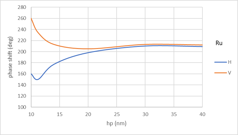

Also the phase shift depends on pitch and line orientation: Understanding and measuring EUV mask 3D effects (spiedigitallibrary.org)
