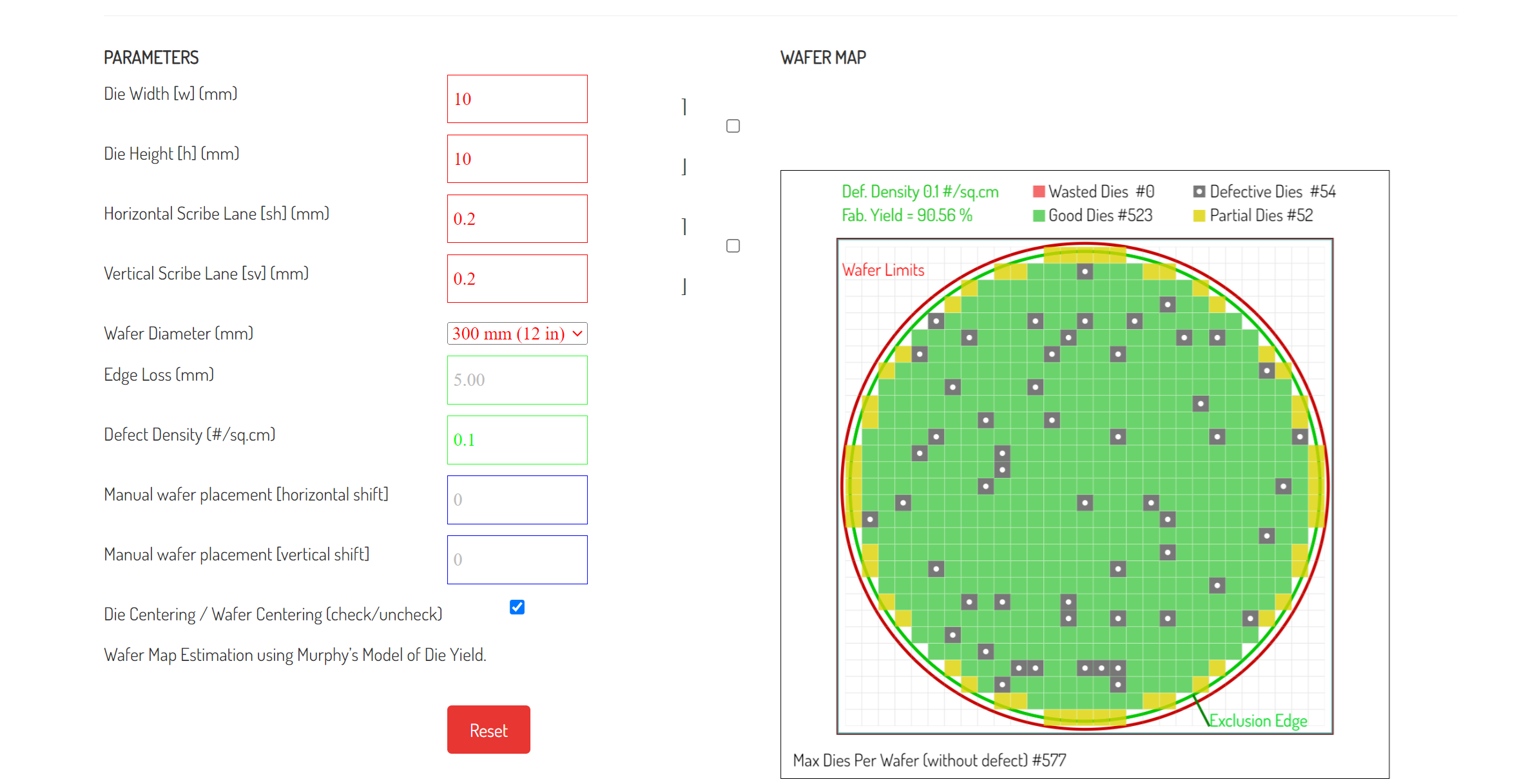

This is a neat site for die yield calculations: http://cloud.mooreelite.com/tools/die-yield-calculator/index.html
