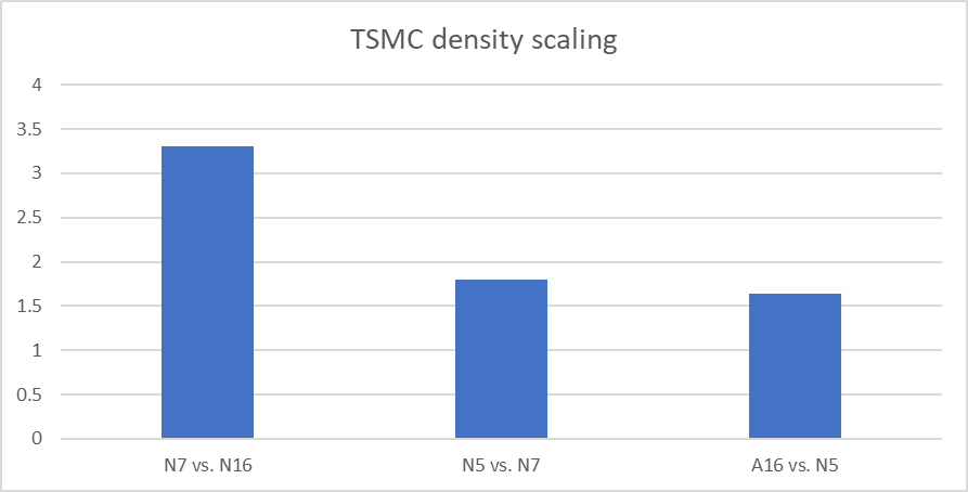

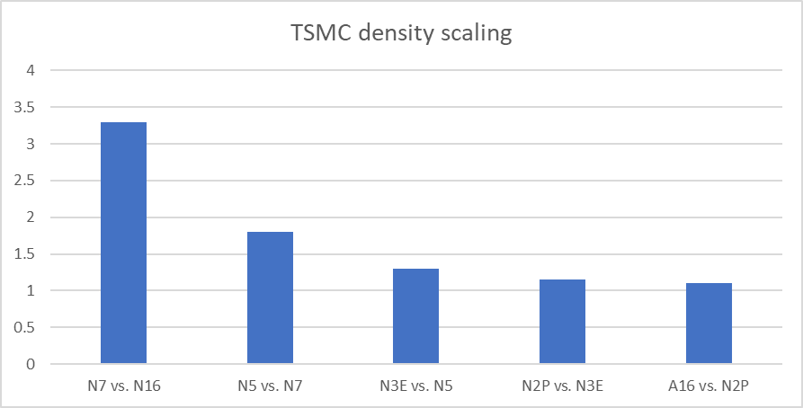

A recent Anandtech article https://www.anandtech.com/show/21408/tsmc-roadmap-at-a-glance-n3x-n2p-a16-2025-2026 prompted me to do a trend plot for TSMC density scaling by node (starting from N16), also using https://en.wikipedia.org/wiki/5_nm_process and https://en.wikichip.org/wiki/7_nm_lithography_process as reference.
Here is a brief version:

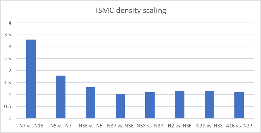

and here is the full version including more of the N3 and N2 sub-nodes:
A classic full node scaling should have a density scaling factor of 2, and we start to fall short of that already at 7nm going to 5nm. It continues dropping going to 3nm, and afterwards, there is practically no scaling (to now). We probably saw signs of this already in the flattening of the SRAM cell size trend. Of course, we expect the others like Samsung and Intel to feel the same difficulty.
It would be interesting to do a trend plot comparing nodes every 3 or 4 years rather than yearly; and see how much it changes. How close do they get to 2x performance?
Thanks Fred! I really thought N5 to N3 was a bigger jump than that.. It looks like it will take N5 to A16 to match the density improvement that N7 to N5 brought.

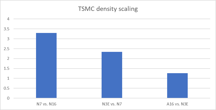

If we do skip nodes, we get something like:
N7 vs. N3E would exceed 2x density scaling but still not go as far as N7 vs. N16. A16 vs. N3E, however, would have very little scaling.

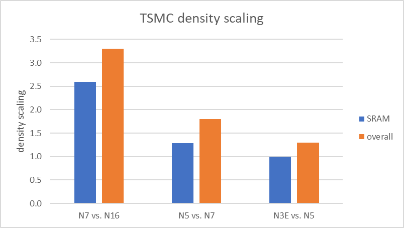

Similarly, we can take N5 as the dividing point:
It's a bit more evenly divided (N7 vs. N5, and A16 vs. N5) but both still short of 2x.

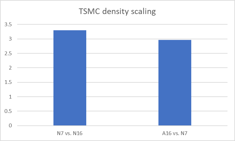

We can go further and divide at N7, that gives more than 2x almost evenly divided between before and after N7:

Thank you. N10 vs. N7 would be closer to 2x; and A14 vs. N5 might or might not reach 2x, but it's all speculation at this point.

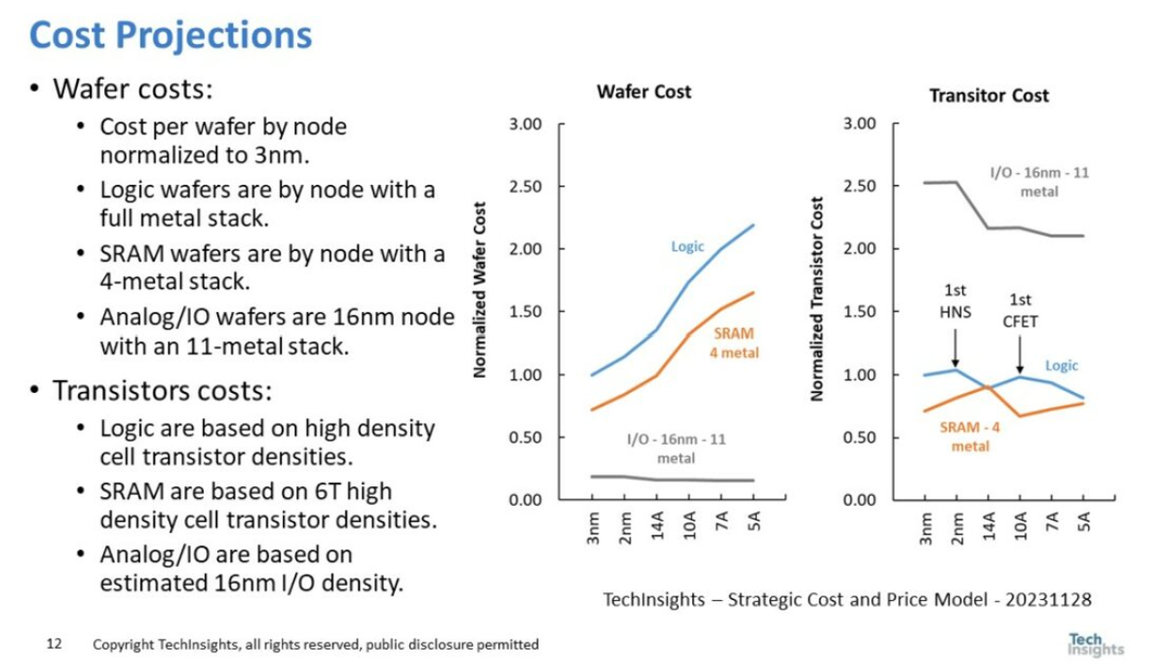

With density scaling slowing so much, and tech being added to create a new node - what is cost per transistor doing between N4/N5, N3, N2, (TSMC not Apple) A16?
