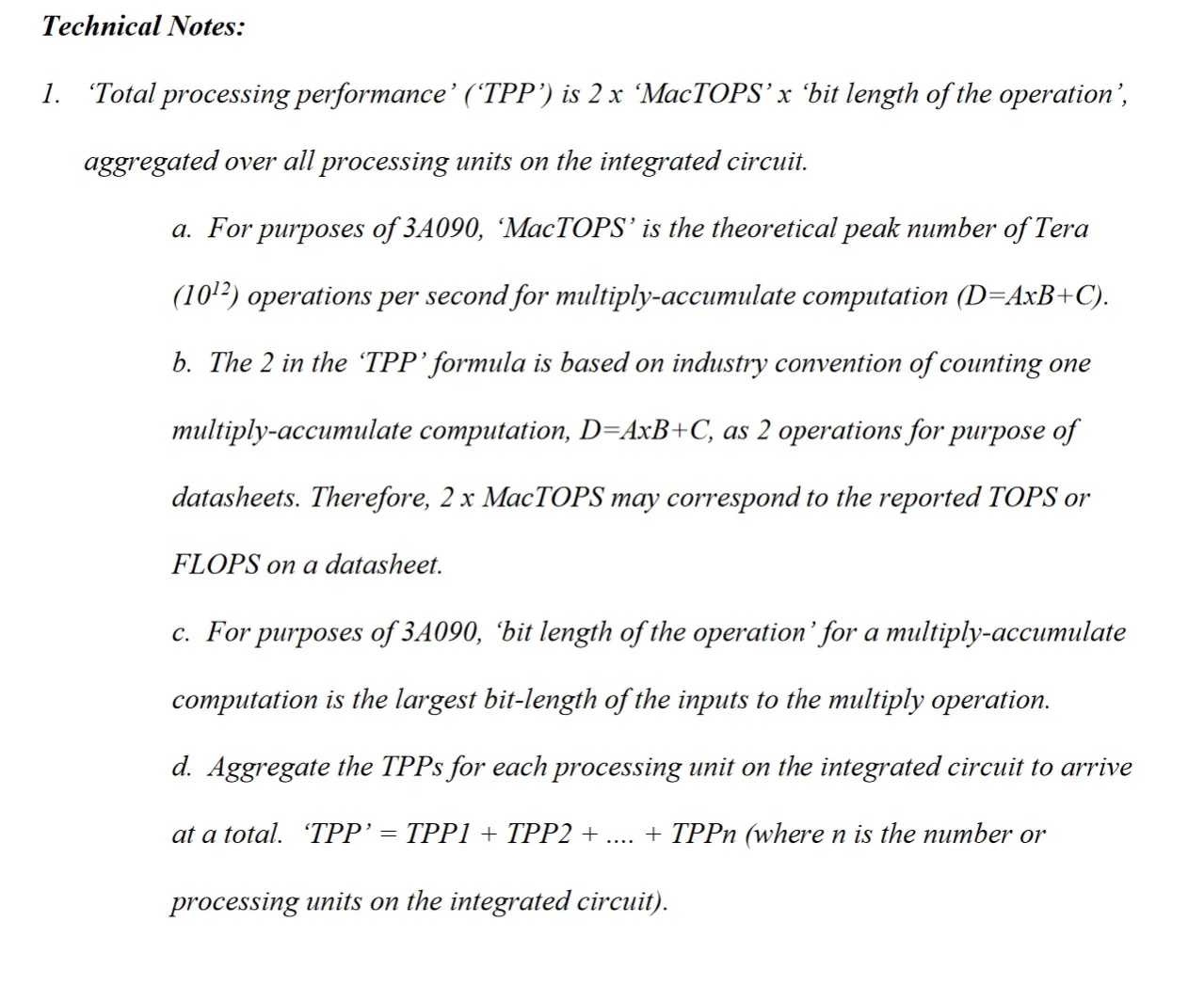

Already saw various different calculations of Nvidia A100 or RTX 4090‘s TPP. What’s the correct way to do it? For bit length, for example, should I use FP32 or FP64, for example?
