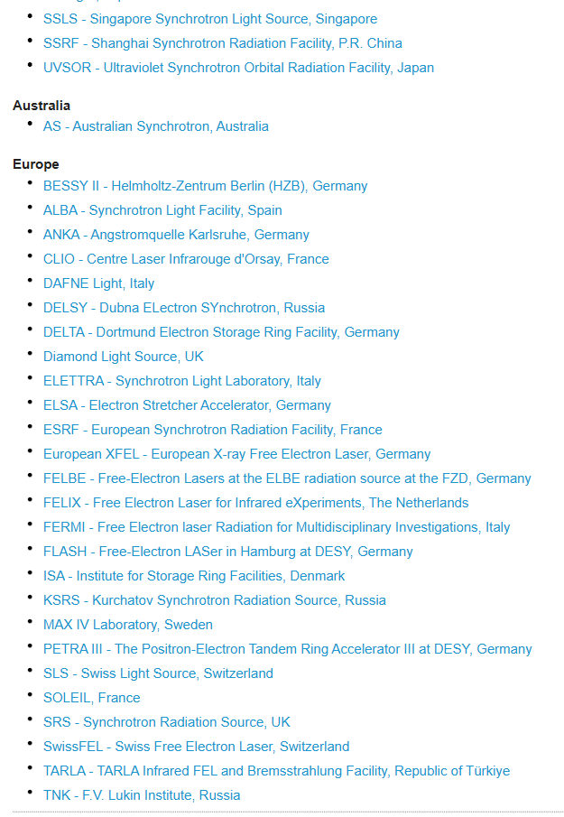

Synchrotron radiation source provides tune-able wavelengths and X-ray Lithography capabilities have been discussed for more than 3 decades and there are several light sources in the world as list below. As we remembered the alternative: MBDW (multiple ebeam direct write) pioneered by Mapper, tsmc Burn Lin-KLA and more were not successful, and David Lam may still work on it now (attached his video in 2023 below). The challenges for advanced lithography for pitch below 40nm are not just in light source only. It is easy to talk and very challenging to achieve production ready scanners.
