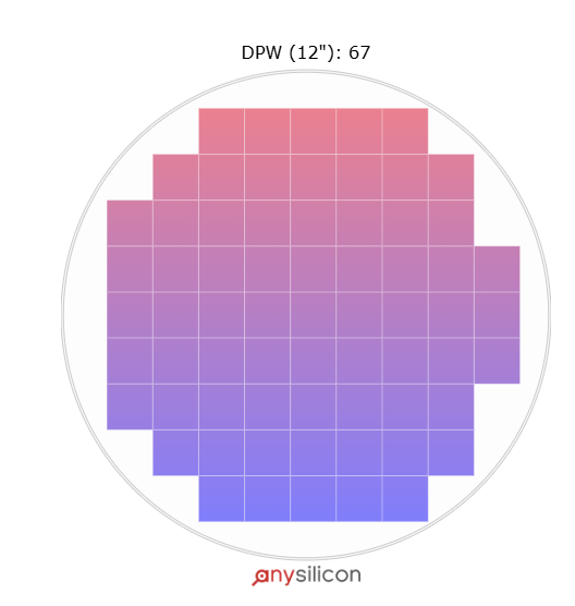

I am trying to figure out the Blackwell chip price.
1. According to Wikipedia the chip is 28 x 28, so I took this information into this die per wafer calculator and found out there are 67 dies per wafer (link: https://anysilicon.com/die-per-wafer-formula-free-calculators/)
2. The price per wafer (4NP) is ~15K according to this page: https://anysilicon.com/wafer-cost/
3. For now, I will assume the yield is 50%
4. The price per die is ~$450
Is this correct?
Thanks for your answers.

If you want the die price contact Techinsights. They know the numbers. Everything else, including anysilicon calculators, is nonsense. 50% yield is a low number for TSMC. If you are going to use a gross calculation with these software toys use a minimum of 60%. People who know yield and die cost find this type of thing entertaining so thank you. 😀
50% for a large die isn’t bad. What matters is the DD
