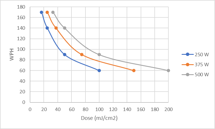

Contrary to expectations, doubling power doesn't mean doubling throughput at same dose (it's less).
