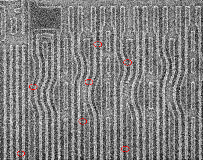

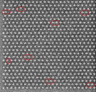

The High-NA results for DRAM revealed defects.
With the known central obscuration in the pupil, the ability to pattern multiple patterns simultaneously is compromised in quite a few cases, particularly the variable pitch metal layers including 2D portions.

Why does DRAM want wavy 1D lines Fred? As a logic person that looks super bizarre, and based on you not calling it out I assume the wavy-nes is intended rather than some distortion issue.
Yes, of course, this is a feasibility study. IMEC is and has never been focused on yield, all they need to do is prove that ONE instance works. :) Their fab is not very clean, with respect to gas-phase contamination, they have a much higher tolerance for defects.
It's not mere contamination because there is pattern dependence.
How do you conclude that there is pattern dependence? It seems that in your images there are multiple instances of the same pattern with only a minority of them having the defect.

The defects were in the DRAM pattern not the other images. For the 19 nm pitch metal pattern, the only thing I noticed was tip-to-tip "roughness" (some tip-to-tip gaps wider, some narrower). For the 30 nm center-to-center via pattern, the image is not clear enough to judge the shape uniformity, and there is also no known reference to check for missing holes. The 22 nm pitch 2D pattern looked clean, though maybe it is least interesting of the four (not a realistic application). https://www.imec-int.com/en/press/i...dram-structures-using-high-na-euv-lithography
