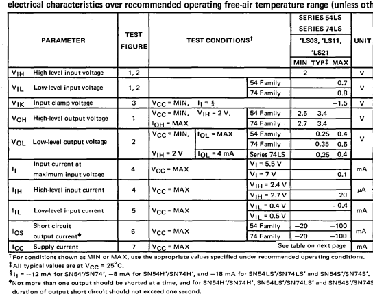

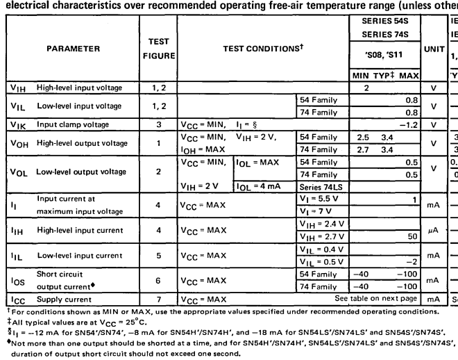

EDIT: If you measure the voltage on the input that isn't connected to the supply, you'll probably find that it's around 1.7V (that's what I recall it being for TTL, don't recall if LSTTL is different) which isn't a valid LOW or HIGH:
Looking at that schematic I would expect unconnected inputs to float high. If there isn’t any current flowing through one of the diodes to pull down the 20k resister then the input will be pulled up to a diode drop below the rail. That’s a solid high level.
Looking at the schematic, I'd expect a floating input to be 2 diode drops above ground; so 1.4V. What I measured was around 2V. That would seem to satisfy the minimum voltage level for a HIGH input, but noise can easily be coupled to the floating inputs. Play it safe and never let inputs float.
I also noticed that I posted specs for S08. LS08 below
