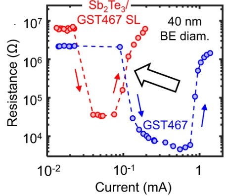

It looks like RESET current scaling is still a challenge for PCM. https://www.nature.com/articles/s41467-023-42792-4
