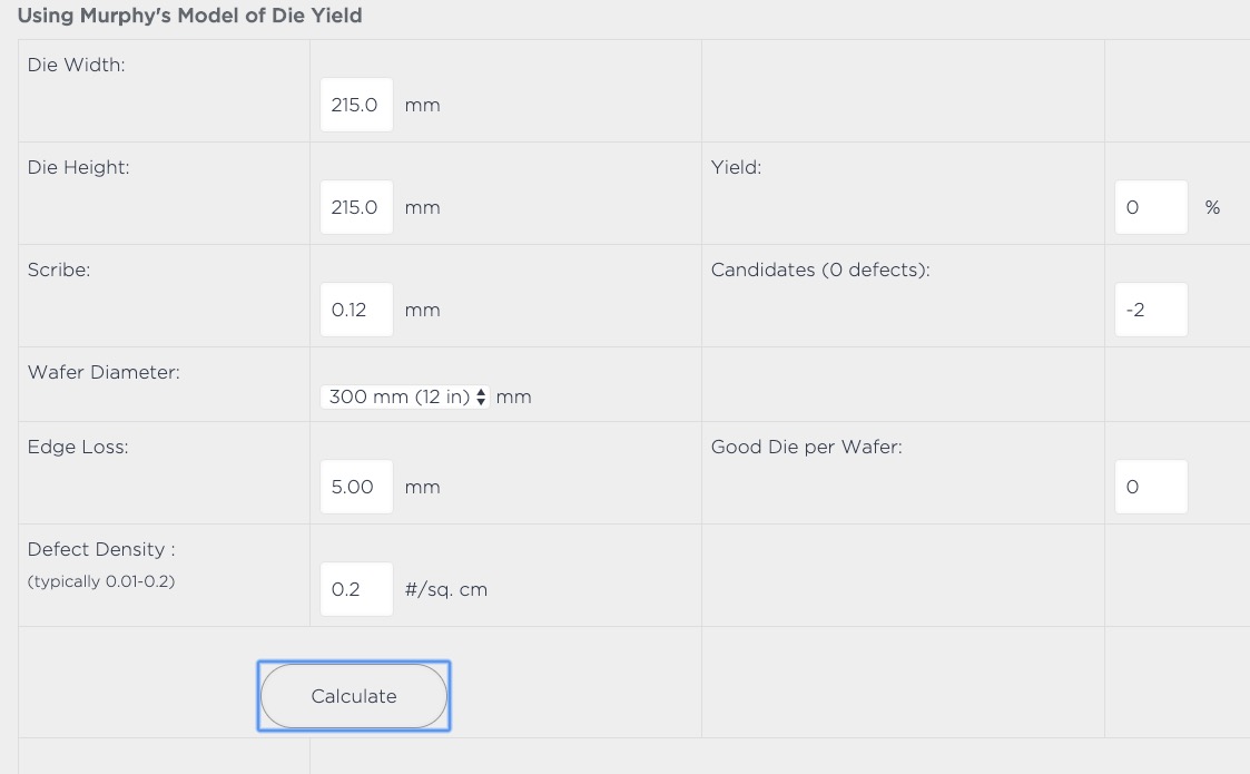

Cerebras used a TSMC 16nm process, but somehow they worked to increase the reticle size beyond 32mm x 26mm to fill an entire wafer, or it's likely that they did multiple exposures at the maximum reticle size. I really haven't heard of other fabs doing full-wafer chips because the yield approaches 0 as the die size increases. Visit this site to predict die yield, http://www.isine.com/resources/die-yield-calculator and place Width=215mm, Height 215mm, Wafer Diameter=300mm, and it predicts that the yield = 0%.
