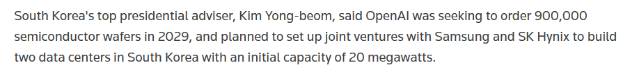

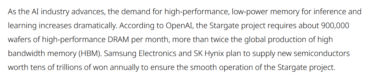

They mentioned 900,000 wafers per month in the press release. It's more than half the proportion of all DRAM wafers made per month currently, not just HBM, so the volume is incredible. Most of the news outlets reporting on this in Korea is assuming this volume to be the expectations by 2030 riding on the growth trajectory of AI over the next few years. As blueone pointed out above, their press release on the OpenAI website doesn't say it is exclusivelyfor OpenAI, but in the media:
The top presidential adviser was quoted saying 900,000 wafers in 2029, and the article above suggests that's more than twice the entire current global production capacity of HBM. They'll need a lot of new fab space in the near future to accommodate such volumes, that's for sure!
