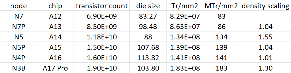

The transistor density on an N3 (specifically N3B) product is already available:
So the Bionic chip density scaling rate is lower at beginning of N3 compared to beginning of N5.

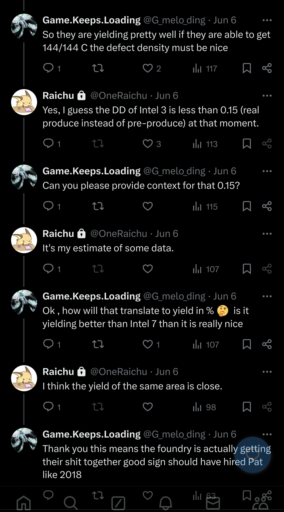

Is Intel doing better on Intel 3 than N3B cause here is one leak from Twitter I don't know what DD 0.15 means here but he says for same die yield of Intel 3 is close to that of Intel 7
intel 3 DD less than 0.15? If it is true, I will blame Pat G to be too conservative to mass production intel 3. Even for tsmc, it will take at least 3-4Q to reach that level after risk start.
Hi NA EUV is not production ready and has low single digit pre=production tools available.
Can you please tell me what will that translate into yield % an approximation https://x.com/OneRaichu/status/1798678499747836002 here is the tweet link btw

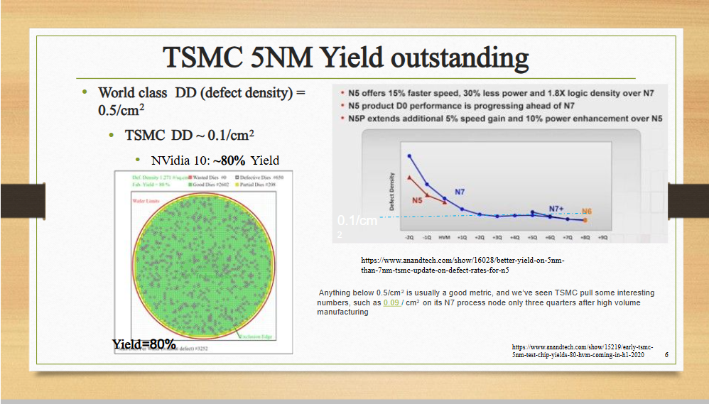

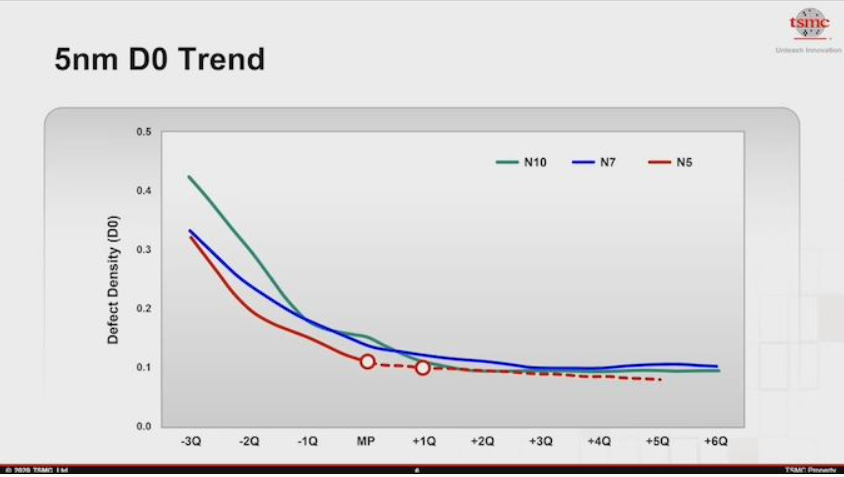

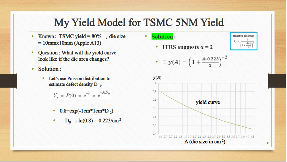

Don't be too lazy. Wafer CP yield is correlated to die size. There are lots of public info available. Here is one of them.
All these yields are stated with such confidence in posts and original sources. IMO they are guesses and gossip.
A small group at the fabless know. Few have direct visibility of multiple generations and x company but the end goal for all companies is simple enough, LOL
D0 must be >0.5 to have 50-60% so it would not be on a trend plot presented by TSMC such as above so this should be just starting out.
